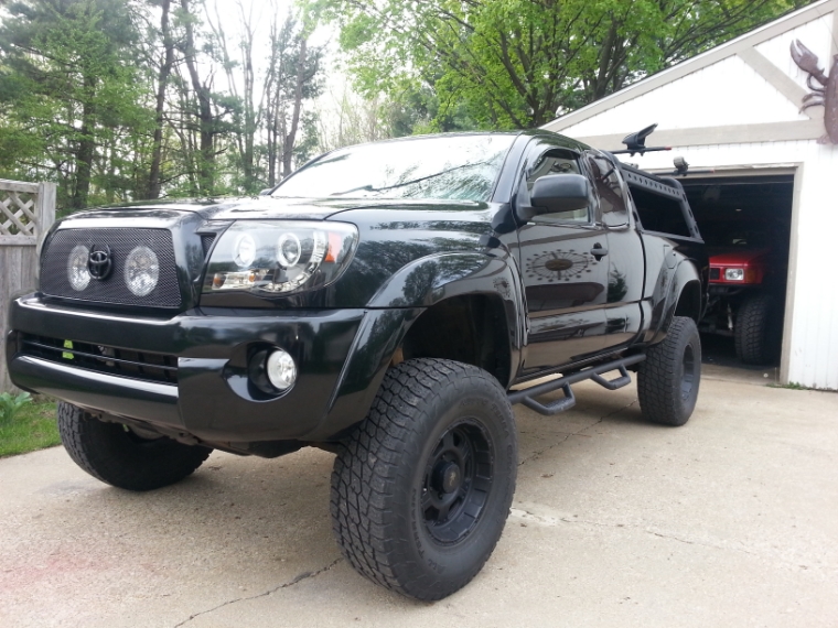

This is Stacey....2006 Tacoma
Lindsey, an 87 4runner, just had a heart transplant....with triple sticks..

Holy smokes man those look phenomenal. Nice work!
Is Lindsey rocking TG bumpers front and back?
