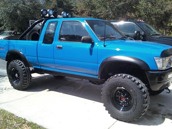

Just got my truck licensed and insured to put back on the road,but dont have a radiator shroud.So far it seems to be ok.Anyone ran without one without overheating issues?Oh yeh.....got new shoes on today!

By the way, those tires look like ass
Would have looked good if you would have brought them to me... Today would have actually been perfect too. REAL slow day. Oh well, less heavy s hit for me to do I did pick up a couple swampers today for myself though... just to throw on one of my extrra wheels as a spare. 1 heavy thing is way better than 4 heavy things!

i've been runnin mine for a few years without one, but im in KY. nice lookin rig, buddy.
