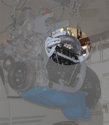

Sprung a pin-hole sized leak and the local auto parts place can't find it in their books. It's leaking anti-freeze/water. The hose appears to be wire reinforced and has an outlet that goes to a heater hose.
Any help on IDing this hose would be appreciated.
Picture for reference.

lower rat hose from engine to the elbow hope it helps

That's not the lower radiator hose.
The lower radiator hose is the hose in the lower left hand corner of the picture.

take the hose off and take it to the parts place.

That's the hose that connects the water pump to the metal elbow. I'd probably call that the water pump outlet hose to the NAPA guy. But like abecedarian says, take the hose to the parts counter and match it. Doesn't matter what you call it as long as it matches the new one.

ok so i was off by a lil bit but thats what i called it when i got mine new i said lower rad hose and they said what one the 1st or the 2nd i said the short bended one and they looked at the pic and thats what it was it goes from the pump to the elbow and then the elbow goes to the lower rad so its the 2nd lower rad hose but thats just what the store calls it so i dont know

When I replaced mine with my water pump, they just listed 2 lower hoses; pump to pipe, and pipe to rad... that would the the pump to pipe one... but yeah, just bring it with you up to the parts store.

I took the hose off and took it in to find out they don't have anything resemling it. I guess I'm off to the service counter at the local Toyota dealer.

you must be getting the newbies at the parts store...
The guy I talked when I got mine knew exactly what I was talking about... but he's also an old school parts house guy that's ASE certified... it's why I go back to him every time. Try out an Advance Auto Parts first before the stealership; that's were I got mine from.
I have 3 of their part numbers for hoses (stuck in my repair manual in the little notes section) that I got when I did my H2O pump...
B70815
B71383
C71262
Tell the guy (or gal) at the counter that you want to see those three hoses; I'm not sure which one is which; they don't have descriptions on the stickers that I kept, and it's been so long since I messed with them; but tell them a former employee told you one of those are the ones you need. I worked there for 2 and a half years; I KNOW they have them...

Just for additional info if anybody else runs into this problem as well.
Napa Part #: NBH 7564
In their system it is named:
Hose - Radiator Lower: Comment: Engine to Pipe @Cut to Length@
