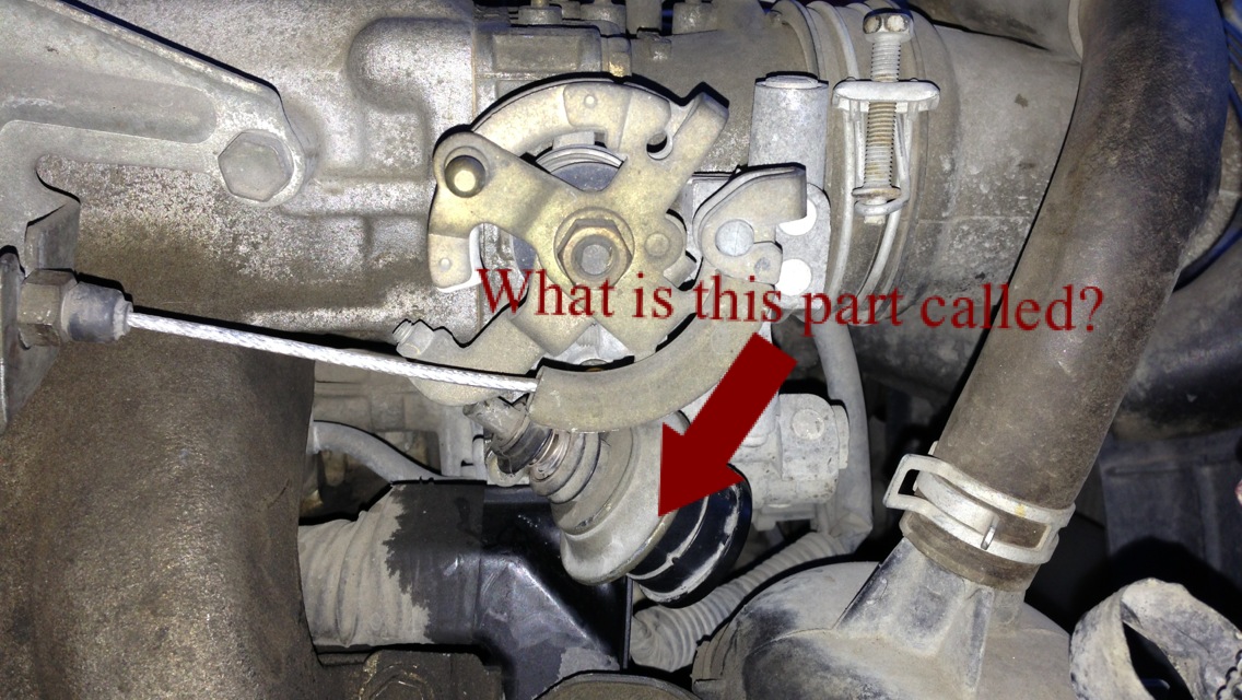

what is this throttle related part called? Truck bogs on acceleration.
I'm looking to replace this part but I don't know what it's called and if I can't figure it out I'm going to have to drive an hour to the dealership so they can look at it so I've attached a picture of it.

Throttle Dashpot

Dashpot. And as Toyota4x4907 says, it's not your problem. (If you care: http://www.autoshop101.com/ technical articles / Air Induction System)

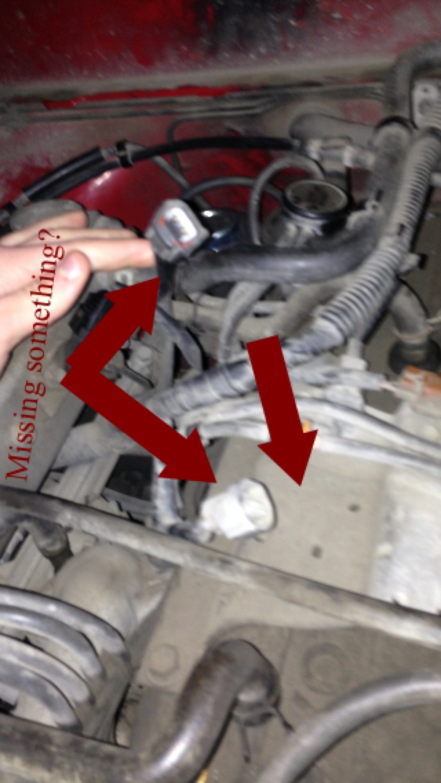

Autozone has a collection of vacuum routing diagrams, should help you figure out which valve you are missing.
Give the routing a once and twice over. Since it's happening under heavy load, eg low vacuum, my brains to foggy today to recall whats operating then. Sorry.
I can partly rule out two of your check list however. The bi-metal vac switch, only turns on it's portion of the egr system, Your's isn't hook up so thats not it. The injector PWM is integrated into the ECU, nothing really to service or replace.

Test the fuel pressure regulator vac switch. Also it looks like it's hose is loose in your picture, theyre generally the rear one IIRC.

Gotta jumper the check connector, E1-TE1 (somebody check me there) while warmed up to set base timing. The plug hanging out on your valve cover isn't used, I have the exact same plug, hangin out, lookin good. You have the same dash pot I had, but I removed mine, since it was holding my idle up too high. Doesn't really do a lot that you notice. The COR shouldn't affect your heater, but there is a little resistor that does. Or a fuse. Check my sig, there should be an FSM that covers you.
