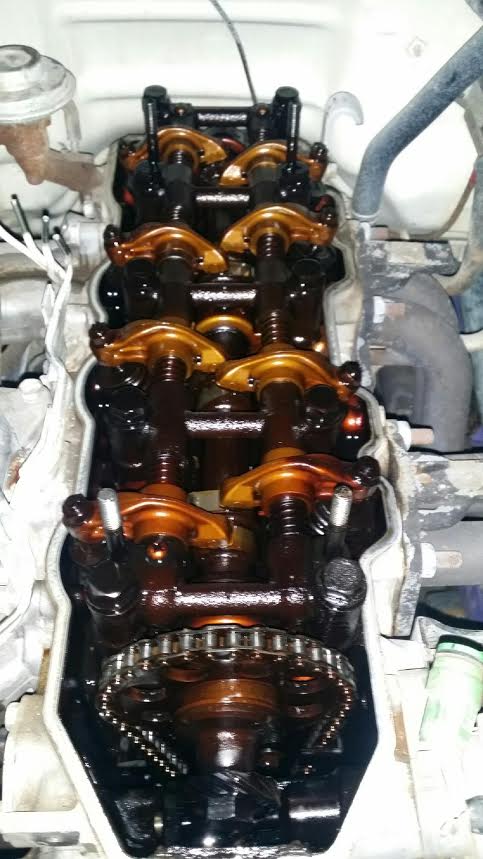

Thanks all! Oh and here is a picture of my motor with the valve cover removed.
