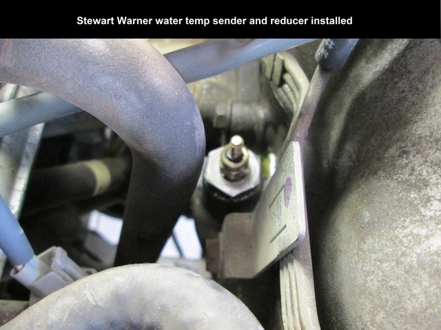

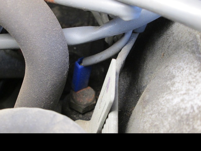

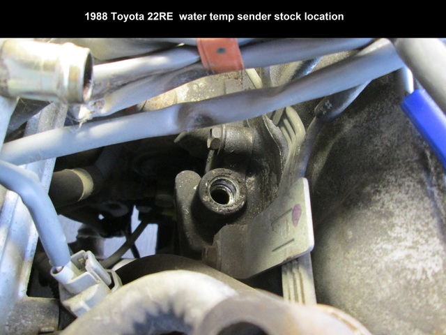

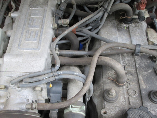

Water Temp Sender Location. 88 22RE
The original water temp guage sender is located between the intake chamber and valve cover with
the blue connector, this location can be used for most aftermarket senders with an adapter.

I've read there's two, one for the gauge and one for the EFI system. Is this right? Maybe someone has a picture of that second one to help clarify the difference? Don't want to sub-out the wrong one!
