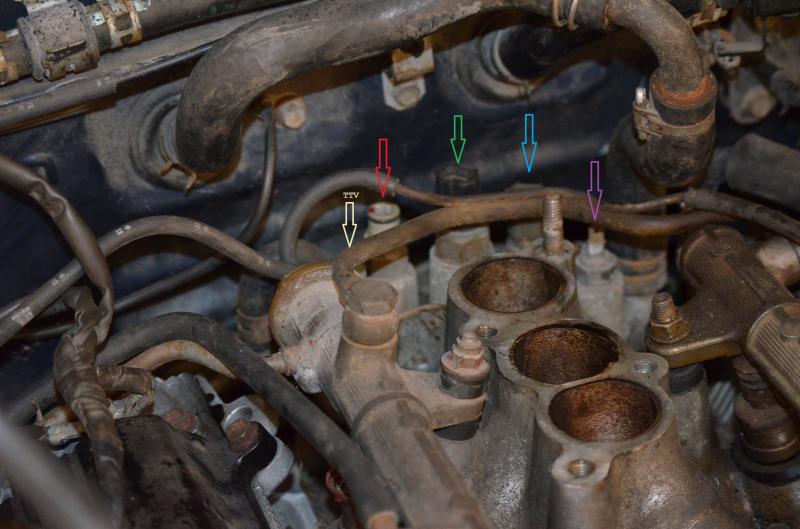

Water Bypass Manifold ID Help please.
I would appreciate help with identifying these sensors. Additionally, does anyone know which color wire goes to the purple single post plug? That is the temperature sender I believe and when I put everything back together, there was nothing to plug in there (worked prior). I am only getting a code 22 and the corresponding problems related to the ECT sensor, which is a hard starting vehicle. Sorry about the shotty typing, I just had surgery in my left wrist and elbow.

One of the two sensors cryptically marked "temp. gauge?" is for the gauge on the dash, the other shuts down the A/C (only in 4wd 3VZE automatics).
