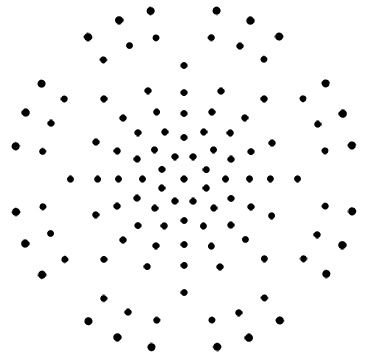

After asking around locally at the stereo stores and upholstery shops, I've learned that perforated door panels are done by hand. Bummer. I didn't want to do them. Well, as a Photoshop user I figured I'd use the program to precisely design my perforations in the door panels. Below is the low-res web image. Naturally I'll be working from a high-res image as a template which I will first stamp out with hole punches on the backside of an aluminum "No Trespassing" sign.
Perforation pattern for vinyl over speakers.
