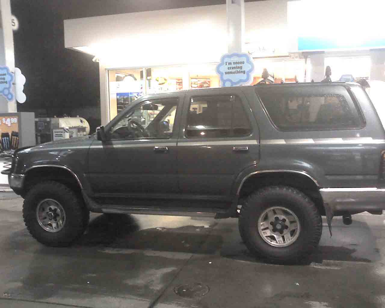

after getting a lifetime free alignment and inspection from firestone I got an AOK (clean bill of health) and was told that everything was in tip top shape. I could still feel that something was not right however so I dropped by a local toyota mastertech's shop for a second opinion. (only toyotas). boy oh boy was I in for a surprise. He did a thorough inspection on my rig and next thing I know we are having a long talk (even after the shop closed for an hour) and the end result is that I left the rig in the shop all weekend as I was told that it was in my best interest not to even drive it for the time being (to be on the safe side!)
how can I get a clean bill health from 1 shop and later the same evening be told that it's not even safe to drive? well I'll tell you..and all I have to say is that it was very lucky that I got a second opinion...
first up I am missing the bracket that holds the intake plenum up (this is for a 3vze) and holds the longer spark plug wires away from the headers. one wire was burned through and was arcing, this was my main indication that things weren't running right. this means that the upper intake plenum was quite unsupported. we're just getting started.
reed valve is completely loose and wobbling, the thorley header attachment point doesn't fit the stock reed valve properly, this is causing a major vacuum leak and has pulled several important vacuum lines away from the plenum. I am told that something needs to be fabbed for this.
the exhaust's first only real attachment point is AFTER THE MUFFLER...meaning that the whole front of the exhaust is being held on by the headers, putting incredible strain on those headers... and will cause a crack due to the lack of support. he can't believe they have not cracked already. this speaks very highly of the strength of thorley headers thank you thorley
rear pan-hard drop bar is improperly installed and needs help. (rear suspension is unsafe)
front idler arm is so loose that there's almost an inch of free play in there...how could I just have been given an alignment and a clean bill of sale the same day? they showed me that the alignment would have been different depending on there the front tires were 'placed' before the alignment...ph wow...
it gets even better...
big oil leaks from the heads, power steering leak (needs new pump), oh yeah....
starter is so close to the headers that it is apparently being cooked every single day, and that's the reason why I've already lost one starter already...so it needs a heat shield made for it, this is a major priority I am told. various wires and hoses are also being cooked due to proximity to headers and need to be rerouted
and the biggest issue is that after the headers and cams and inatake have been installed, nothing has been done for the fuel mixture...and that I am running LEAN LEAN, off the charts lean. My check engine light has been disabled otherwise it would apparently be on all the time. I am advised that at the very least the vacuum leak and reed valve issue needs to be fixed first, and then a proper reading may be able to be taken, and I may be able to get back to spec, otherwise I may need bigger injectors (10% bigger). if that doesn't work I am told the best way is to get a piggyback unit to monitor the fuel mixture. I am told that this lean-ness is a major concern and needs to be fixed immediately. this is something I need a second opinion on from YT if possible. I would like to avoid a piggyback for now if possible, this is a major expense I am told.I need to learn more about tis bigger injector/computer/running lean issue. he is very concerned about this.
so I left the 'runner in the shop. I am advised that some of these issues are so critical that it's best not to even drive until they are addressed. I was shell-shocked after hearing all this so I obeyed!
I do have some good news from all this...
all of these problems are fixable, there is no catastrophic damage yet, while there are major issues, they can be dealt with. I have been lucky. if the headers had cracked, if the exhaust had fallen, if there had been a fire...this would have been MAJOR. as it stands, my rig is still intact, and will be way better when these changes are made.
-he thinks the choices in aftermarket parts is simply incredible. this is thanks to my friends on yotatech.
-he thinks with proper integration and 'cleaning up' that this rig will be rock solid and much safer.
-I will have much more power when the fuel mixture is taken care of.
-the shop is close to my place of residence making things much easier.
-the tech really knows his stuff. after a long talk, I trust him and can see that he loves the toyotas and has worked on them for many years. he knows the 3vze really well, much more than everyone I have personally met except of course for dudebud and weasy and daryl who are incomparably good. unfortunately they all live hours away from me or I would be bothering them all the time!
bad news-
downtime may be lengthy (at least a week to start with)
cost looks like it may start adding up bigtime. I do not have an estimate yet however they are not cheap. I do not have a quote yet but the shop rate is $90 which brings tears to my eyes
i have a family and can't believe that I had so many issues...I will feel better when this is taken care of...I hope to hear from any 2nd gen owners and hear opinions about these issues if possible,
thanks for listening and comments and thoughts about these issues and priorities are more than appreciated: I am sincerely grateful for them

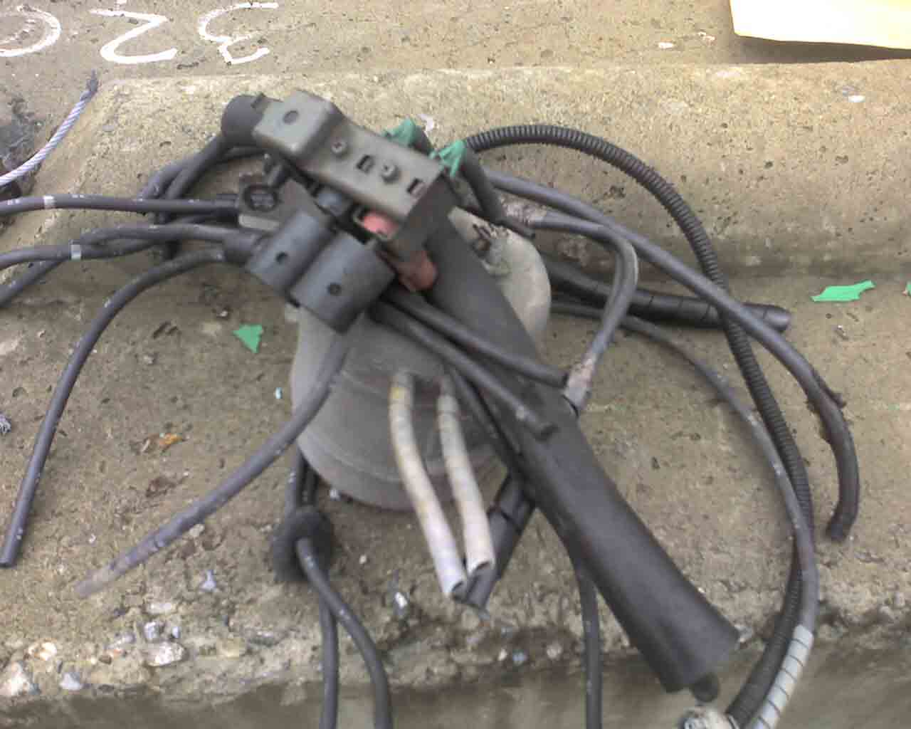

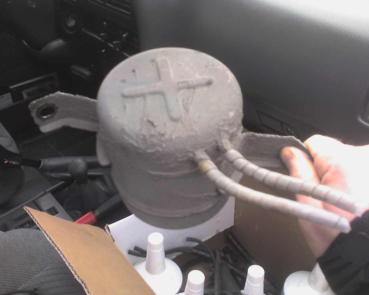

well this shop did a great job. ben at ralliround in seattle, near lake union. they know their stuff and I picked up the 4runner today. here's everything that got done,I was surprised to see quite a lot of parts and vacuum hoses that were on my passenger seat when I returned: removed from the engine!
here's pics...I was explained that these are for the now non-existent front differential lock on my runner. (now manual locking hubs w/front truetrac)...will this give me more power now that these are out of the engine?
it was a good experience at ralliround, not too many parts were required, mostly oil (changed to synthetic redline again, bought a case), starter wrap kit to blanket the starter (it was getting so hot, now is protected in its own little heat-resistant nest but that was a lot of labor as they had to loosen the starter from behind those 3vze headers which imprison the starter...also new vacuum hoses, braided high quality lines, bolts to get the budbuilt on there even stronger...intake manifold bracket, oil filter, that's it! costs were mostly labor. especially dialing the fuel mix in properly (including vacuum leaks) and sorting out the danger to the starter
they also reset the fiel mixture at the AFM to proper fuel settings...
