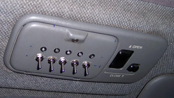

This peace of jusnk kept falling out while I was driving some time ago when I bought my 92 4R, So checking it out there were stress cracks in the spring so I modded it and it then stayed in place.
Well since Im going back into the offroad scene again and needed a place to put light and other accessory switches, That spot seems like an area to start.
Heres the finish product.
Attached Thumbnails A use for the overhead cardholder in your 4R-100_0647.jpg

Nice. How difficult was it to route the wiring?
Ed

Chuki, I assume you dont have a sunroof then.
Just have to pull the ohcrapbar off the drivers side and run it with the existing harness.
It really wasnt that hard, Most diffacult was getting through the firewall grommet where the hoodlatch cable goes through.
I used braided 20ga 9 conductor and its has braided reinforced sheilding, Had it laying around.
sliced and pulled a ACC wire as it passes the fusebox for 3 switches and the 2 others are B+ from the extra fusebox under the hood.
No labels, I remember what I hook up.
