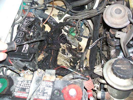

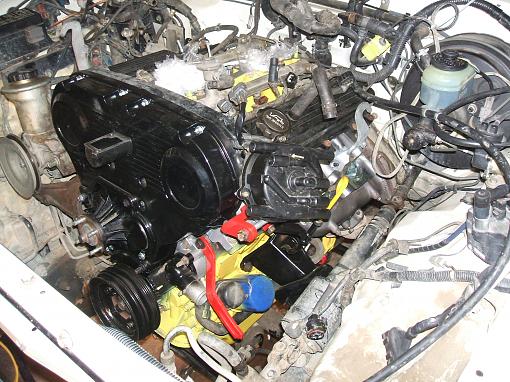

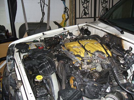

Well it has been awhile, and I have had more than I ever expected when swapping my engine. While about two weeks into the rebuild, my running engine decided it was going to get the worst fuel economy yet (about 2km/L). Now Im getting really worried tyhat my excess fuel consumption is going to hurt the limited funds I do have available.
Apparently some jacka$$ decides that he dosent need to stop at a red light, hitting me on the rear driverside tire....Insurance company dealt with (they figure $4000 damage, there gonna fix it all).
Weeks later, i finally get my "new" engine. After many hours of slow movement and many a select 4 letter words, it is in. I am amazed that i managed to do this on my own (i am no longer an engine virgin). A few hours later I have everything reconnected, and figure sence i only have for some seals to set, i can get the vehicle ready to go. The final step was to reconnect my battery, which in turn pressurized the fuel system (i didnt realize the key was in the on run position). I ran around the vehicle to turn the key off, looked in at the key, turned it off, looked up out the window and there was fire. Simple solution...put it out....there are no fire extinguishers around (im in my friends non-heated garage)....So i call the fire department and wait. As im watching my truck burn....the smoke changes into a thick black color, and it is then I know that all the plastic and rubber are on fire.
The end result looks like it began as a fuel fire (my lack of experience), which after burning some of the wires turned into an electrical fire. I now have to replace both wiring harnesses, all the hoses, belts, fan and shroud.
I spent the day pulling wires from the wreckers, and now know that I am in for quite a job trying to get my truck running again. hopefully I can have this finished soon, life without a toyota just isnt life at all.
