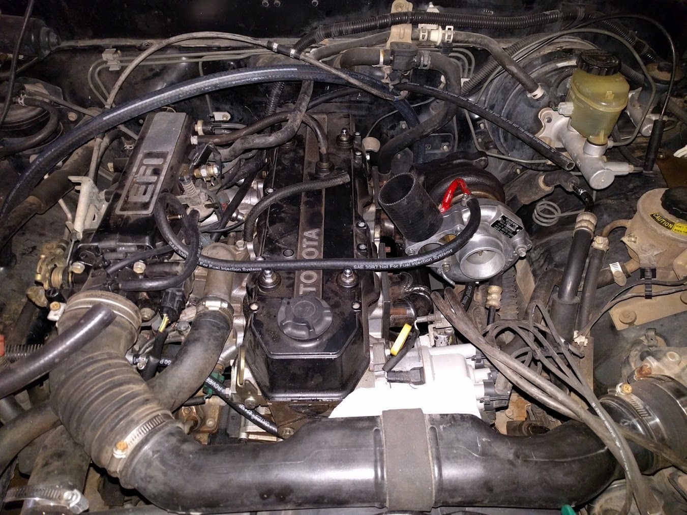

Here is mock up of the turbo approximately where it will be in the engine bay.
https://cimg8.ibsrv.net/gimg/www.yot...e0dc83917e.jpg
turbo position mockup

Test fitted the manifold to the engine today.
https://cimg0.ibsrv.net/gimg/www.yot...347821fcab.jpg
https://cimg1.ibsrv.net/gimg/www.yot...5af35d790d.jpg

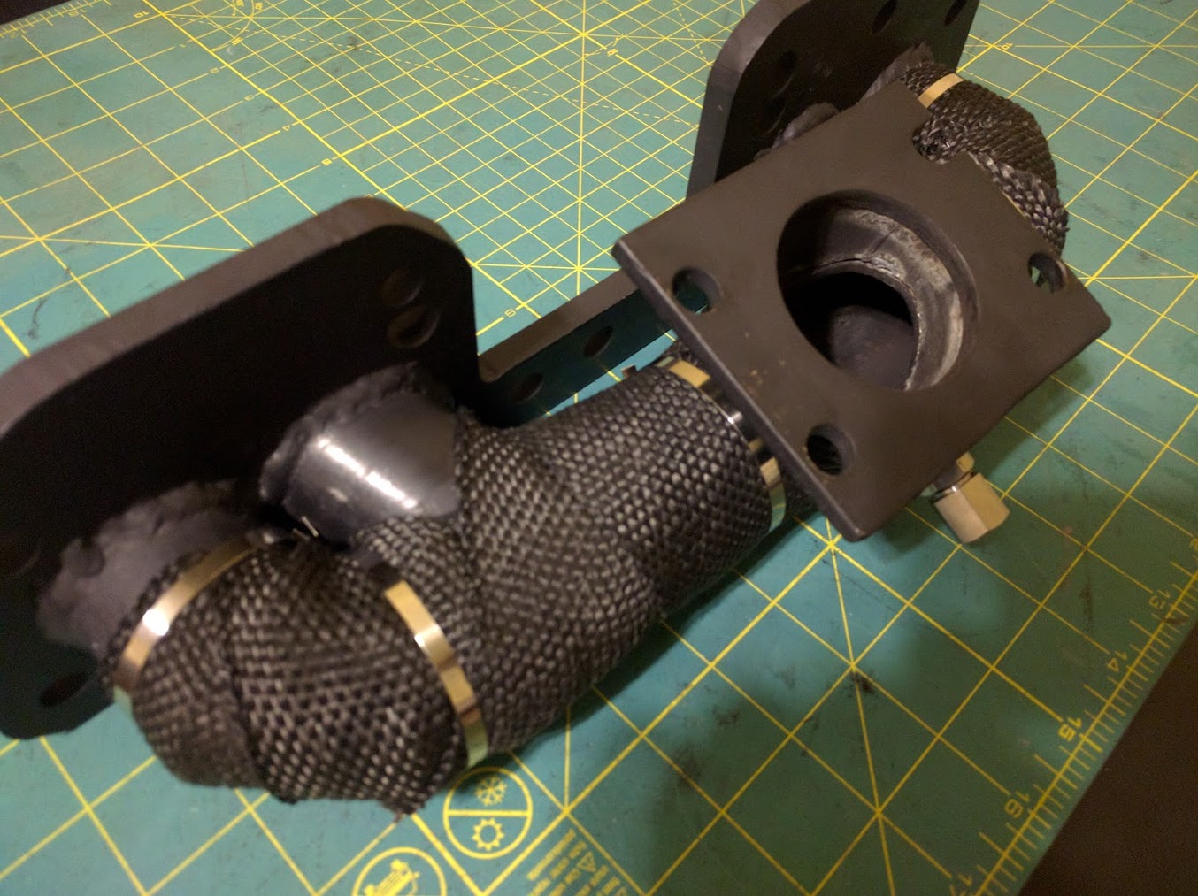

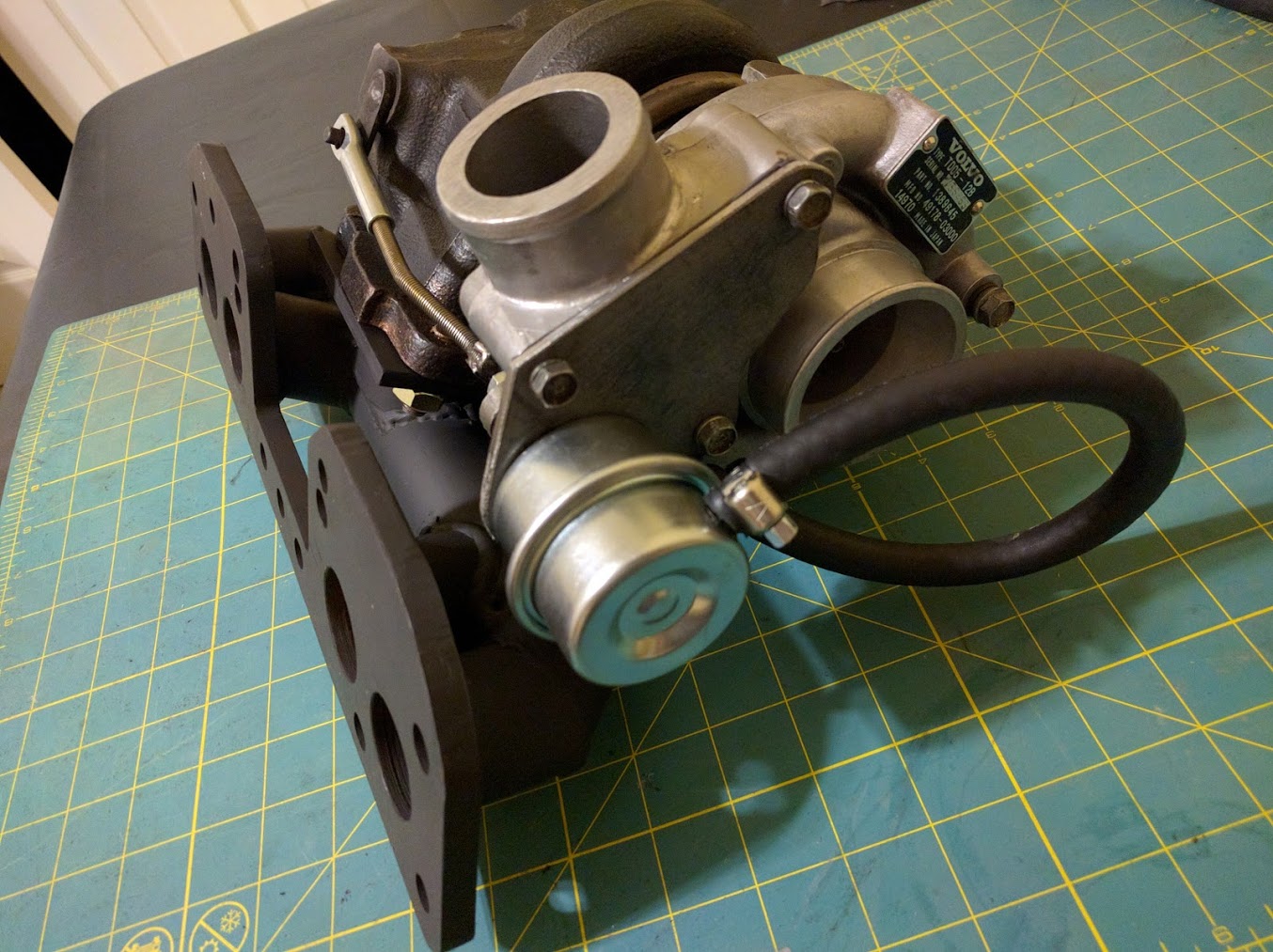

I figured up the wastegate linkages, I had to fab up a new BOV block off plate that included a spot to mount the waste gate, then I added a spring below the waste gate to reduce the max boost to a reasonable amount for this engine, and it is easily adjustable.
I also wrapped the turbo manifold in fiberglass insulation to help keep bay temps down without a heat shield. My intake and exhaust pipes came in today, just waiting on gaskets and some intake couplers to come in the mail.

Over the weekend I welded up the intake pipes, and the turbo downpipe. I cut out gaskets, wired an EGT gauge and all those little things. Tonight I bolted up the turbo, and the downpipe, fitted together the intake plumbing, and plumbed oil and water to the turbo.
I was able to do a test drive (no muffler) and the there is alot of turbo noise :D
