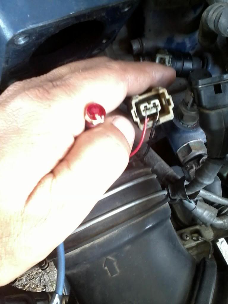

You said you are getting fire, next I would check to see if my injectors are firing. The Noid Light only works in one direction so if it doesnt work inserted one way flip it around before ruling the injectors. If you look closely at the notches and wiring it the picture below you will get the LED into the correct position. Mine is an 86 as well. Any new to me truck, I just count on going thru from on end to the next. I would suspect more then just motor issues.

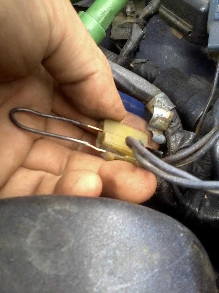

Here is how you do a Fuel Pump Bypass on the 85/86.
Jumper wire the Yellow Plug on Drivers side. ( Jumper wire should be in both contacts for testing, I just didnt have it in for picture purposes and mostly a referece for me at a later time.)

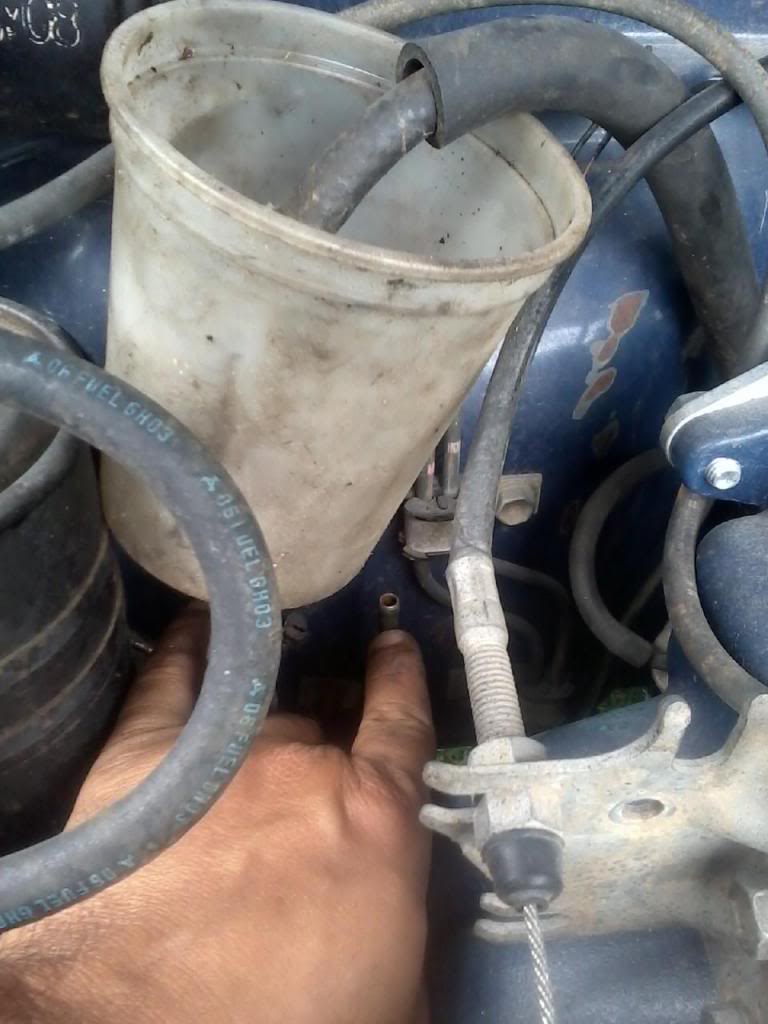

With the jumper wire in and the key turned on, I was able to fill the cup up in about a minute or so. The return hose goes to where my finger is pointing. This is the metal line that I suggest taking an air hose and seeing if it is clear all the way to the fuel pump bracket. I have seen this line and the "J" line on the bracket clogged several times.

My $3 noid light. I was not able to find one anywhere and this worked great. It flickered each time I cranked it. I just could not get any pictures of it lighted.

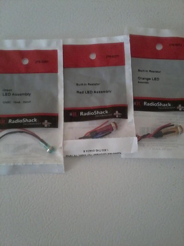

I used the 12 Volt red one. Radio Shack Part Number #276-0270 Name:  airleak4_zps660af941.jpg
