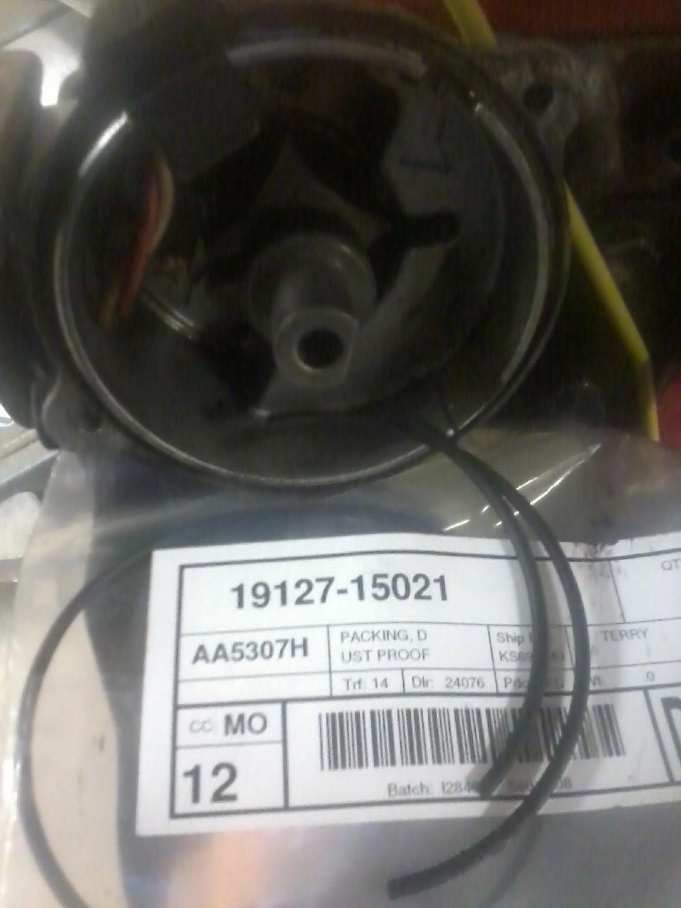

Is there any moisture under the distributor cap after the rain? I use the factory cap from the dealer. There is also an O-ring that goes between the cap and rotor that usually needs to be replaced. I get the factory wires off of ebay for about $30 shipped. Aftermarket ones do not stay in the cap as well.
