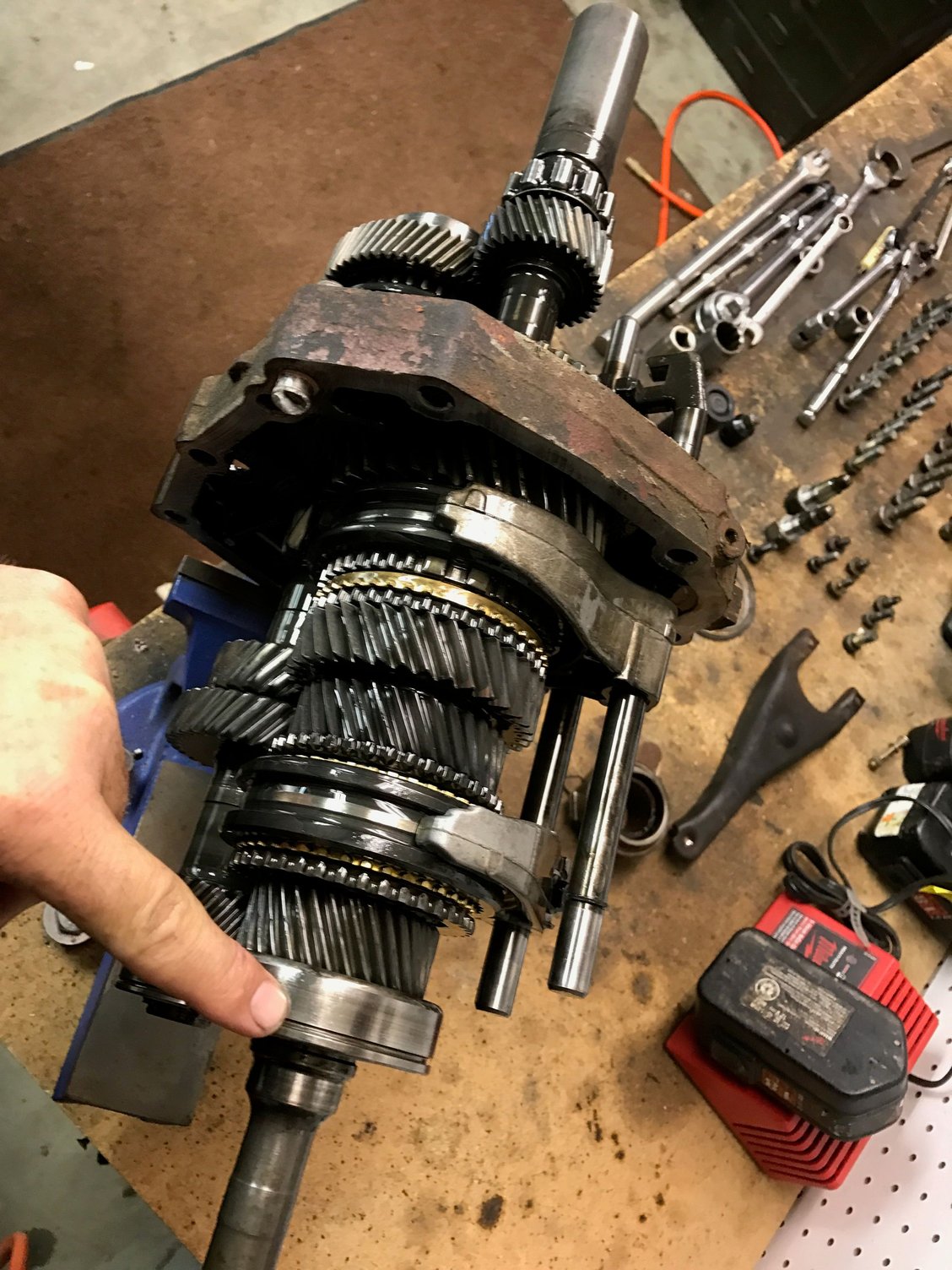

you know what the symptoms are, noise in every gear but 4th, pilot bearing is brand new. could this bearing be causing it? seems to me this bearing would be spinning all the time being its on the input shaft. however, you can see from the pictures that the inner race is shot. what y'all think?

That would make a noise alright. Is it the input bearing??
Is it the only bad one??
Old 01-28-2017, 03:26 PM
tysen86's Avatar
Join Date: Dec 2005
Location: Calhoun, GA
Posts: 259
Received 2 Likes on 2 Posts
yea, its first bearing on the input shaft. its the only one I can seem to find that is bad.
