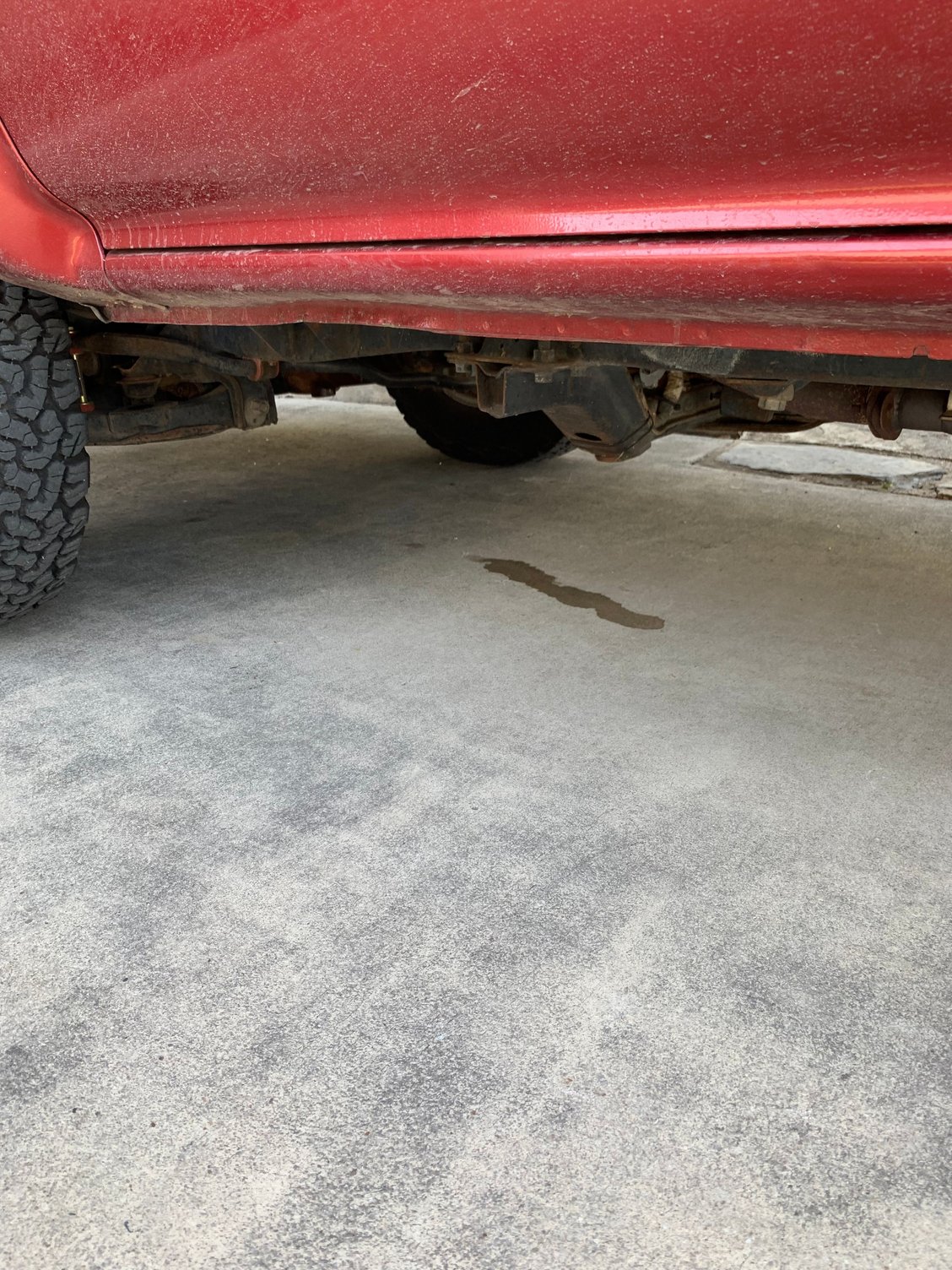

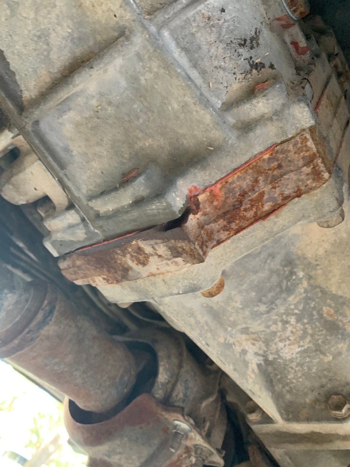

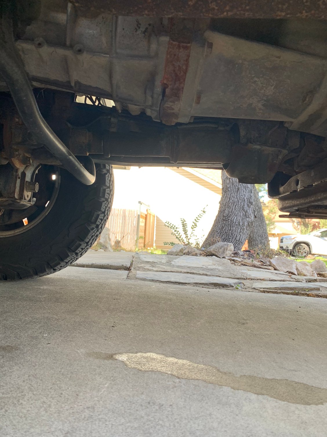

I woke up this morning to this. I don’t drive the truck much. Moved it last two days ago. Wondering what I would call this seal and how much of a pain is it to repair.

Found the issue. Heater hose from near the firewall was leaking , running down the trans and stopping and dripping here. Tightened and all is good. That goodness
