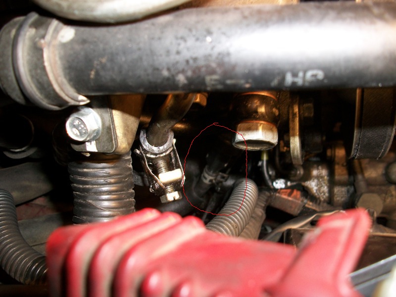

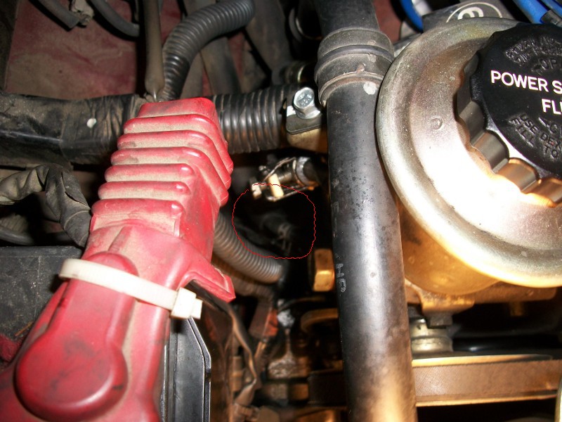

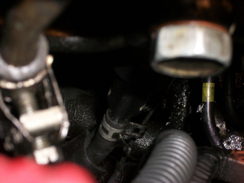

I'm trying to track down a leak in the power steering system, and I *think* I may have found it, but I'm not sure, because I don't even know what these hoses are. I suspect I'm leaking ATF fluid from theses hoses, which is saturating the lower end of the power steering pressure hose, and from there onto the garage floor. Before I go taking things out of my 4 runner, can anyone identify what these puppies do? Or am i looking at a hose that couldn't leak ATF fluid because it doesn't pass any to begin with? I really have no idea. (EDIT: Vacuum lines?) I haven't had to mess with Power steering in any vehicle whatsoever in probably 20 years.
Please see attachments.
Thank you.

Hard to tell from your pix, but it looks like you're pointing to the Air Control Valve http://web.archive.org/web/201102060...11powerste.pdf (3d large drawing), more commonly called the Power Steering idle-up valve.
The two lines are not SUPPOSED to have any ATF (the valve just connects the two vacuum lines, which allows more air into the plenum, raising the idle). But if the diaphragm inside the valve fails, you will be shooting ATF (at high pressure) into those lines, into the plenum. Not good. SO, you might have a very slow leak there. Trace the two vacuum lines up to the passenger side of the plenum, and pull them off. Do you see ANY evidence of ATF at that end? You have a bad air control valve.
The plenum picture in this thread https://www.yotatech.com/forums/f120...layout-233927/ might help finding the hose locations on the plenum. Look at 5 and 13. Like scope said, pull them off the plenum and see if either contain AFT fluid.
