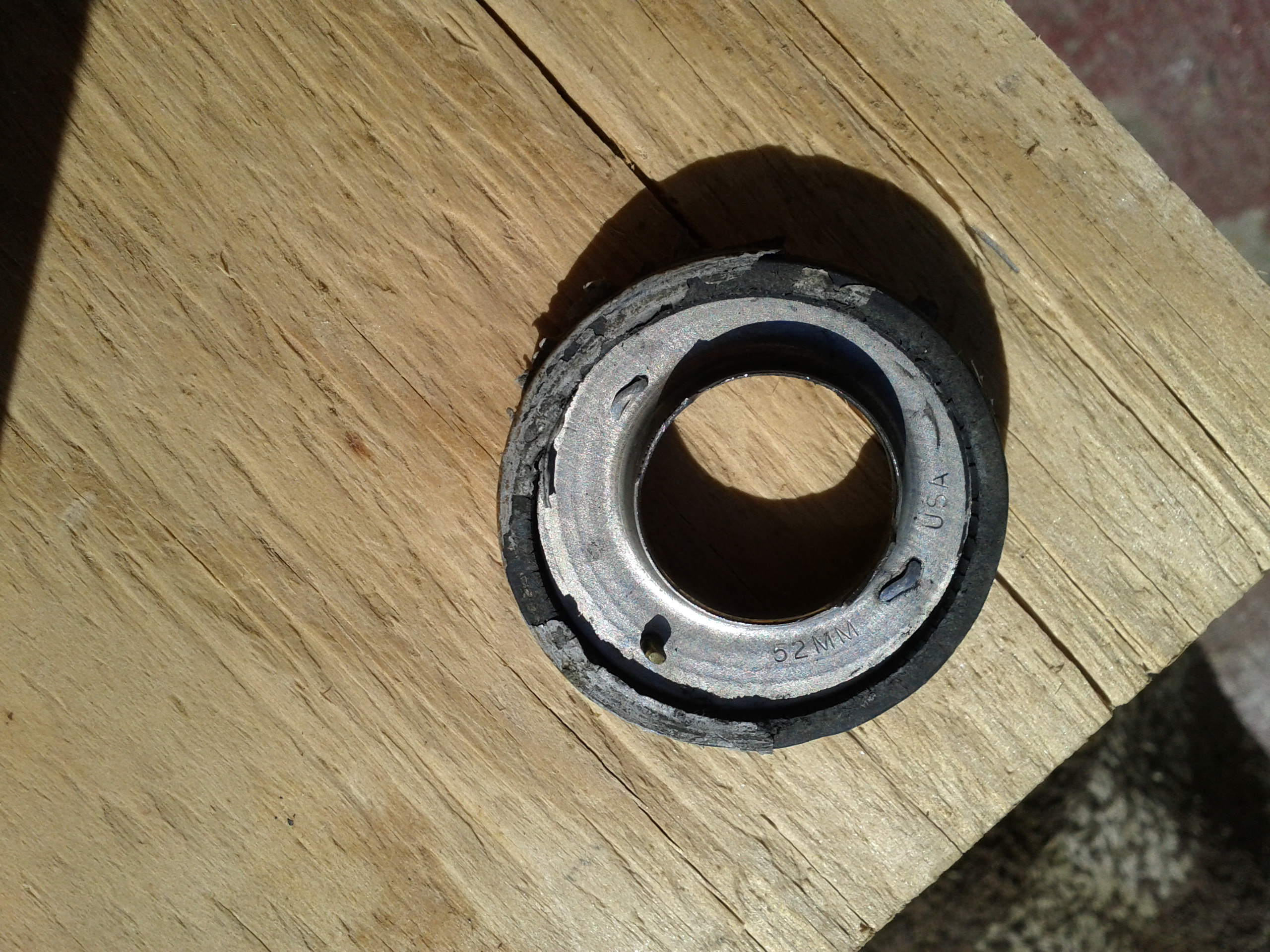

They cut out the center piece of the tstat leaving an open hole. Picture attahed
Ya. Might be air. I jacked up the front end and ran it with the rad cap off though
