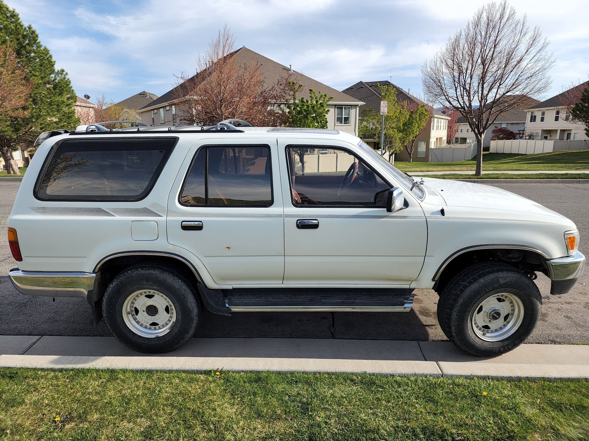

Ok, so I made a leap of faith and picked up a mint Arizona, Manual 94 4runner without a spec of rust and only 145000 miles. The seller mentioned that it just had a blown head gasket and I stupidly took his word. When I got underneath the car today and tried to turn the engine over by hand I found out it is seized. This isn't too big of a deal, as I only paid $800 and think I still got a decent deal. My question is, is it worth it to tear the engine down and see if it is salvageable or should I just swap it to the 3.4. I've never done a swap and am on a budget, but have a good set of tools and mechanical knowledge. If I were to do the swap, where is the best place to find an engine or donor vehicle in utah?

I would think that rebuilding a seized motor would be approaching swap territory anyway, right? If it were me I would probably fork the coin over for a rebuilt 3.4, but my plan would be to keep the truck for a long, long time.

It's in great shape with low miles. Buy a remanufactured engine and it will be almost like new.
I'd also change the transmission and differential fluids, as well as a good flushing of the radiator and heater cores while the engine is out. Flush the brake fluid as well.

Thanks for the input. I have decided to do the 3.4 swap and am currently tracking down an engine! Wish me luck! And yes, I do plan to keep this for a long time. Love these things!
