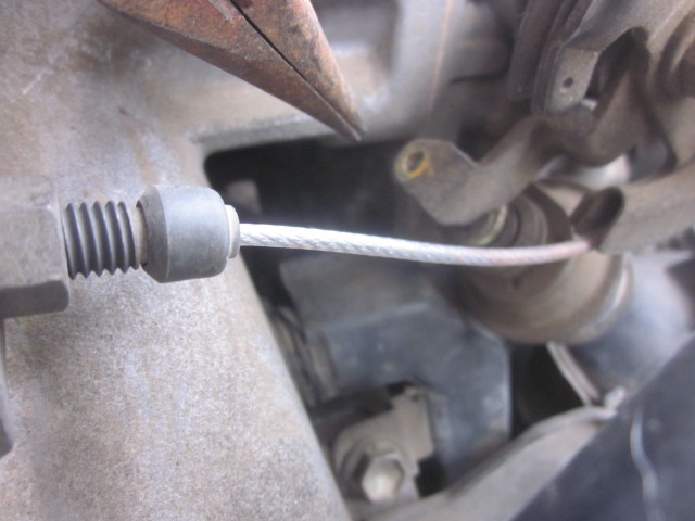

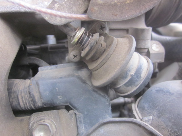

I was driving home from work yesterday in my 94 base model pickup. Went to give it a little gas and it just bogged down to nothing. Thankfully I was able to make it off the freeway. So once i was safely pulled over she was idling super rough and as soon as I added a little throttle the engine would stall. And now the truck won't start at all. Since the power loss occurred when I depressed the gas pedal I started looking on the intake side first.
Any input from you guys would be really appreciated! and I'll make sure to keep the forum posted as I proceed here.
So far this is what I've found:
It looks like this screw is missing. Not sure what this does here or if it might be the problem?

OK the photos above are the dash pot and is not the problem.
