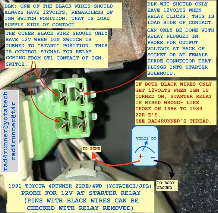

RAD4Runner Nov 10, 2020 01:37 AM
Originally Posted by 1991Patriot (Post 52453263)
This is a 1991 Toyota single cab base pickup with a 22RE and 5 speed manual transmission.
There you go. A problem well-stated is almost solved.
Let's start with this... Do you see this in driver side kick panel? If you do, please do checks in picture.
https://cimg0.ibsrv.net/gimg/www.yot...56f4301485.jpg
