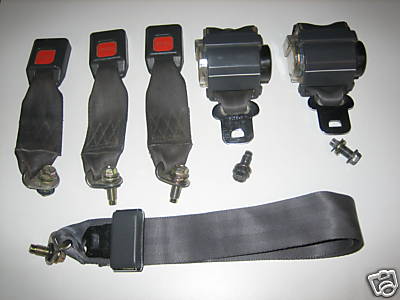

Mine did come with belts, it's just missing parts and it'd probably cost me about as much for parts as it would to buy another set probably. I'm really only missing two male connections back there I think, pretty sure everything else is there. I have one complete belt back there, then two are missing pieces, haha. (I used to work for a particular parts yard and we used to charge out the wang). Anyhow, here's a pic of what I'm lookin at, hopefully it helps....and the pic shows, haha

The pic is of a factory set of belts. Those look good!
They will fit in your truck no problem, again, assuming you had factory belts to start with (I think 88 did) There will be a pocket on each quarter trim interior panel for the buckle to recess into.
