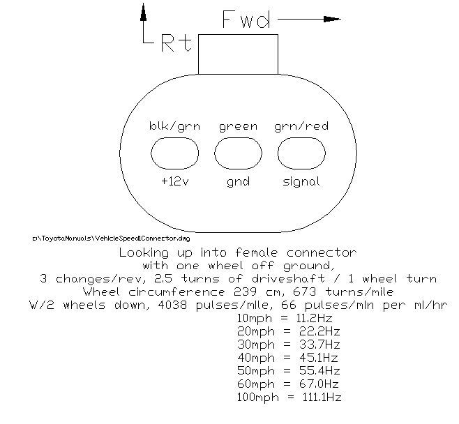

On my '94, the wires to the VSS1 sensor are
blk/grn: 12v,
green: ground,
grn/red: signal
I never tried to trace it as far as the speedometer. I can't help you there.

scope103 May 25, 2017 06:47 AM
I suspect kibbleking has the electronic speedometer, not the cable speedometer. With the cable speedometer, there is a reed switch built into the combination meter to generate the speed signal. With the electronic speedometer, there is a device bolted to the back of the transfer case, with a pickup-gear. Inside the device is a hall-effect chip to sense the rotation of the gear.
There is also a VSS2, which is in the transmission. Since you have a 2-speed transfer case, measuring the speed of transmission does not translate to MPH.
My wire colors are for the harness connection to VSS1. RBX's suggestion is a good one; while the wire colors are usually (?) the same, the pinouts may be more instructive.

Scope, Thank you.. Despite the wire colors that drawing above is Exactly what I found.. I may have the ground and signal backwards..
