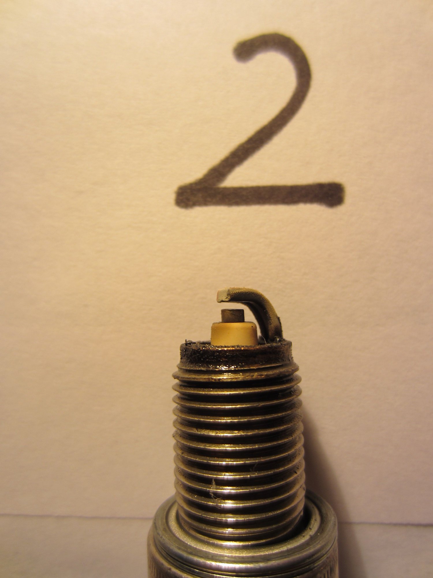

Today I am finishing up an almost complete brake system overhaul on my truck (all original but somewhat mechanically neglected ) and decided to take a look at my spark plugs again. I found that the spark plug on cylinder # 3 has fouled up again with what looks like oil and smells like oil. These spark plugs were changed out about 3,000 miles ago as I discovered the #3 spark plug's outer electrode was in very sad shape (Last pic, NGK). I will post pictures below. The first four pictures are the plugs that I just removed (OEM DENSO).

Old Spark plug from cylinder #3:

Did this sit for some time before you started driving it??
It can only be either the oil ring is rusted and not sealing like it should allowing oil into the combustion chamber.
Valve seals and guides worn allowing oil to enter from the head.
If your not planning to pull things apart a hotter plug in #3 might be a temporary fix till you decide what to do

I know this is about a month old but felt like chiming in since I just dealt with this recently.
Start with the easy things first. I have a 87 with a 22r too. When I took the engine apart I found that my oil rings were clogged up with goopy build up and my second rings were all recessed in the piston.
My first easy suggestion is to get some seafoam and add about a quart to your fuel but before you start it dump some into cyl # 3 and let it sit for a while. After some running much of the built up oil should be gone. Lots of smoke out of the exhaust so don't be surprised. Also replace that plug again. You may get lucky and the valves will re-seat and everything will be good.
Run it for a while and check the plug. If its all oiled up then significant oil is getting in there somehow, this isn't from long years of build up. Either the rings have failed/very worn or the seals are worn out and leaking into the cylinder. There is only a 50/50 chance of replacing the valve seals without removing the head. When you take the headbolts off the seal may be broke, many times it won't and you will be able to replace at least the seals on that cylinder. This would be the easiest thing but if you are burning 2qts per three thousand miles it really does sound like the rings. Try the easy things before you feel compelled to take the engine out and apart.
