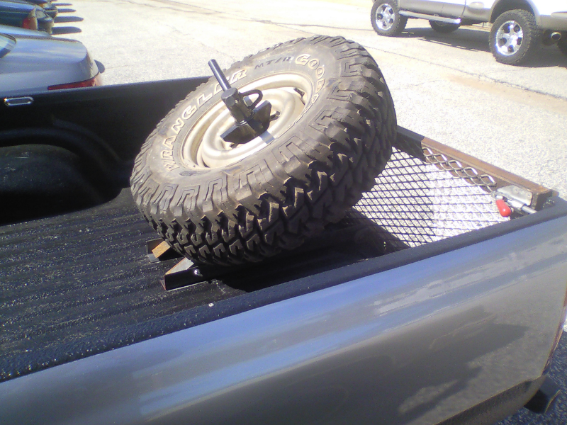

If you look towards the end of my build thread, you'll see my mount. I made it out of a couple of suspension arms off of a Ford Escort (had them lying around). Already had bushings, just mounted some angle iron in the bed, and used 3/4" pins. Whole thing is removable, and currently have a 35" spare on it. Can also be folded flat.
Also, look into Rotopax for a gas can. Real nice setup. Already have a road/trail, and will be getting a gas can soon.

I found the post, here it is to save time. I have since made a toolbox for the bwd that sits in front of the spare. The front legs were removed, and the spare is held to the box at an angle with two hitch pins.
From parts to final piece:
The legs are control and trailing arms from a Ford ZX2.
I used 4 pieces of 1" tubing and bolts to mount the plate away from the legs to clear the tire. I plan to have these pieces welded.
Mounts in the bed with 3/4" pins. Can remove the front pins to lay the tire flat.
