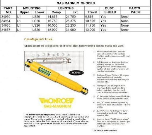

I 'downgraded' from bilsteins to monroes when I lowered my rig - very happy with how these perform. Most autoparts stores have them, lifetime warranty, and CHEAP.
I put this together to make it easier to know what to order - just give them the part number and you're good to go.
