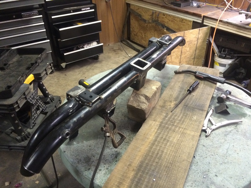

edit since you can weld why not look around, find the features you want (style, light mounts, winch plate, D hooks, etc) and build it. Would be fun! I pretty much made my own I chopped the TG one up so much I considered it my own.

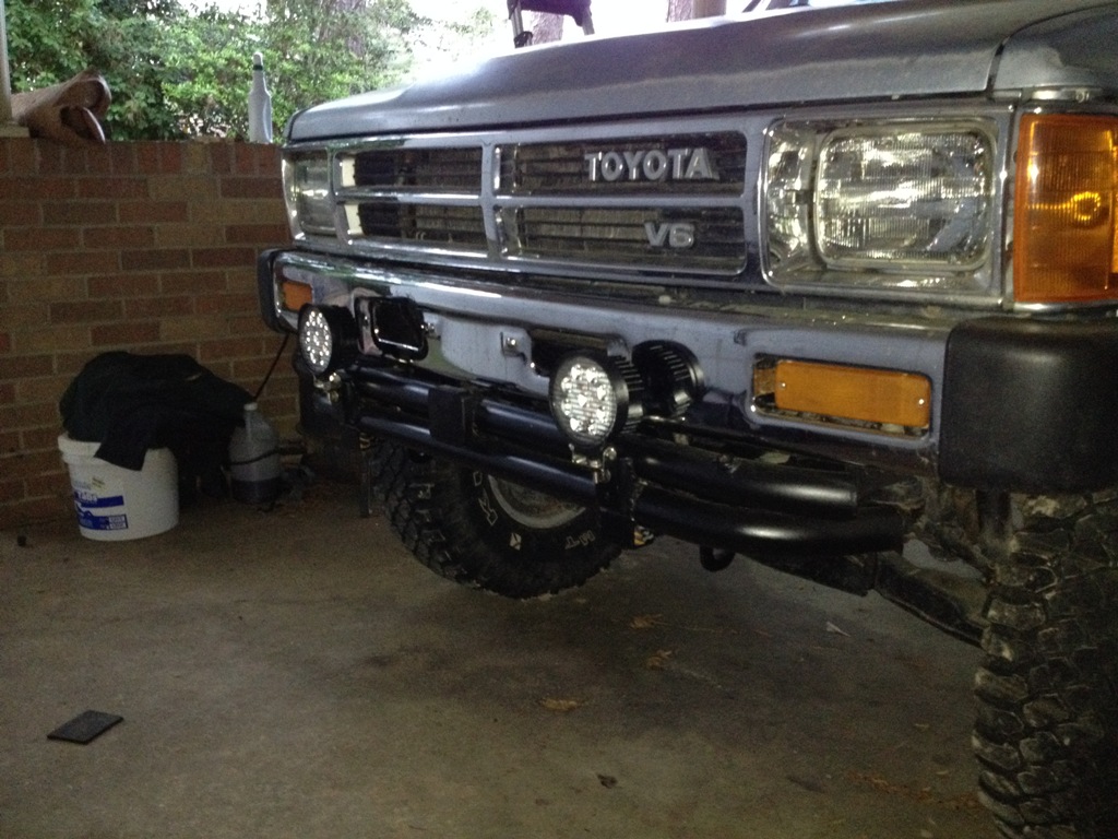

There are lots of good choices for bumpers. I built this little jewel out of my spare roll bar. I wanted to keep the stock look but still add a little protection and wanted to try something I hadn't seen before.
