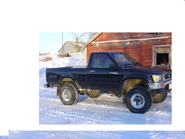

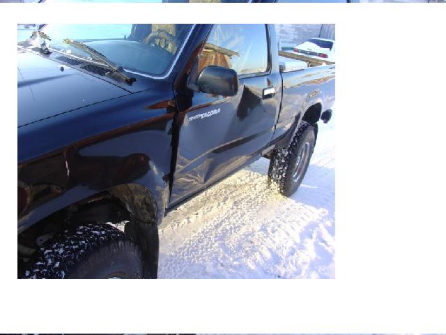

yeh i didnt get the good ones
ya i was not wanting this to happen
Attached Thumbnails Rolled my truck-baby3.jpg   Rolled my truck-baby2.jpg   Rolled my truck-baby1.jpg

you call that a roll? dude get a toilet plunger i bet you can get that door dent out, well most of it, sucks thow
