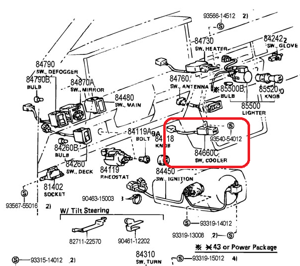

old87yota Nov 7, 2017 08:42 AM
I was going to give you the Toyota part number, but I cannot find the correct bulb. It doesn't show up on the parts diagrams. Oddly enough, Toyota has bulbs for other switches in the same diagram.
https://cimg8.ibsrv.net/gimg/www.yot...f0095a9177.png
For some reason, Toyota did not include the bulb for this switch....
