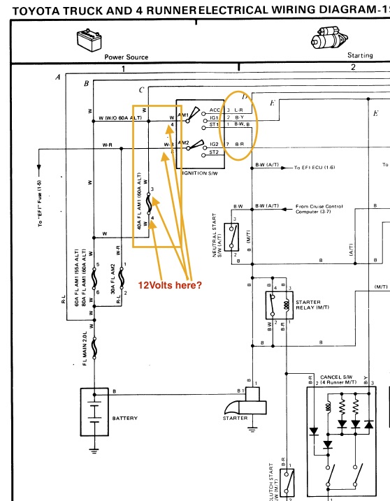

IF you had a short in your alternator, it could have blown your engine fuse (supplies IG pin) which supplies 12V to ECU.
Also check power supply / fuse block for 12V here and outputs of corresponding Ign switch contacts...
