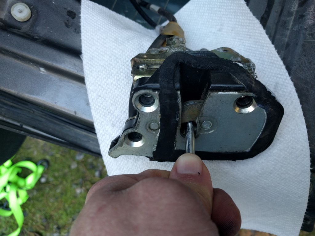

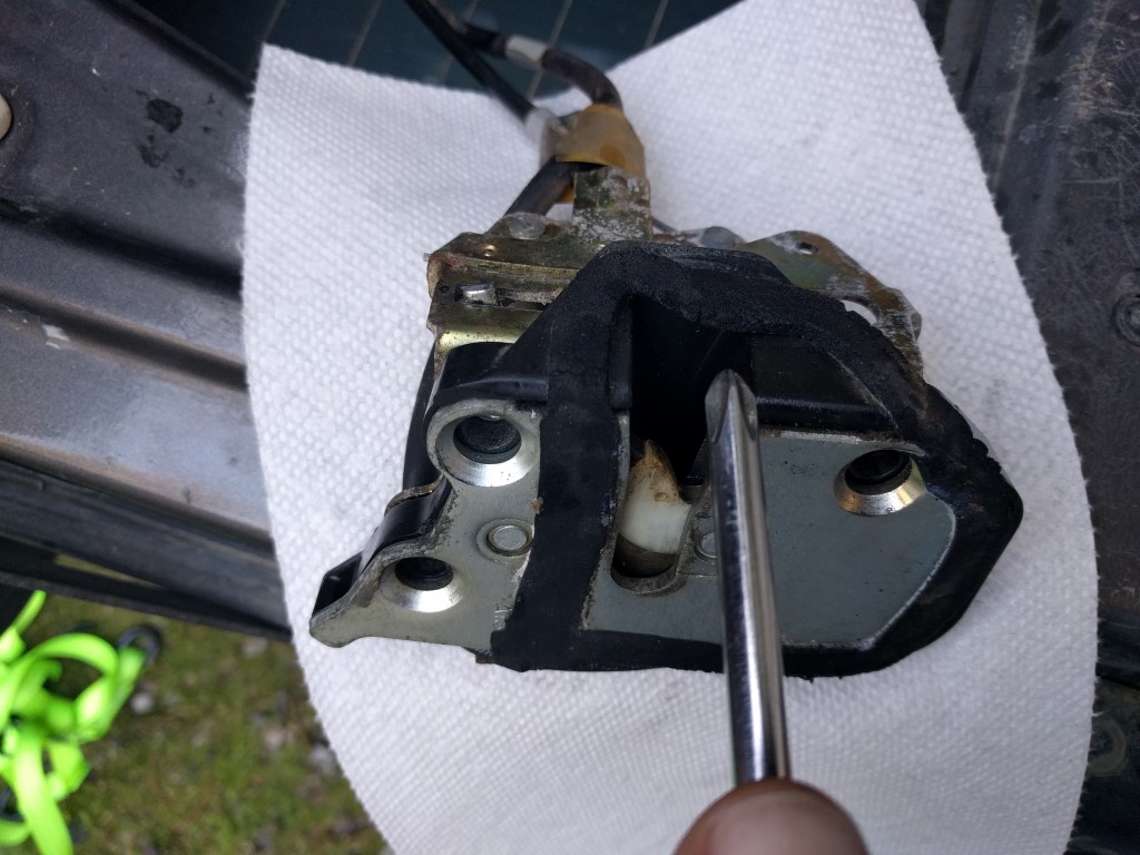

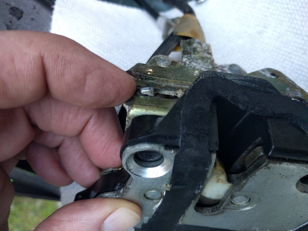

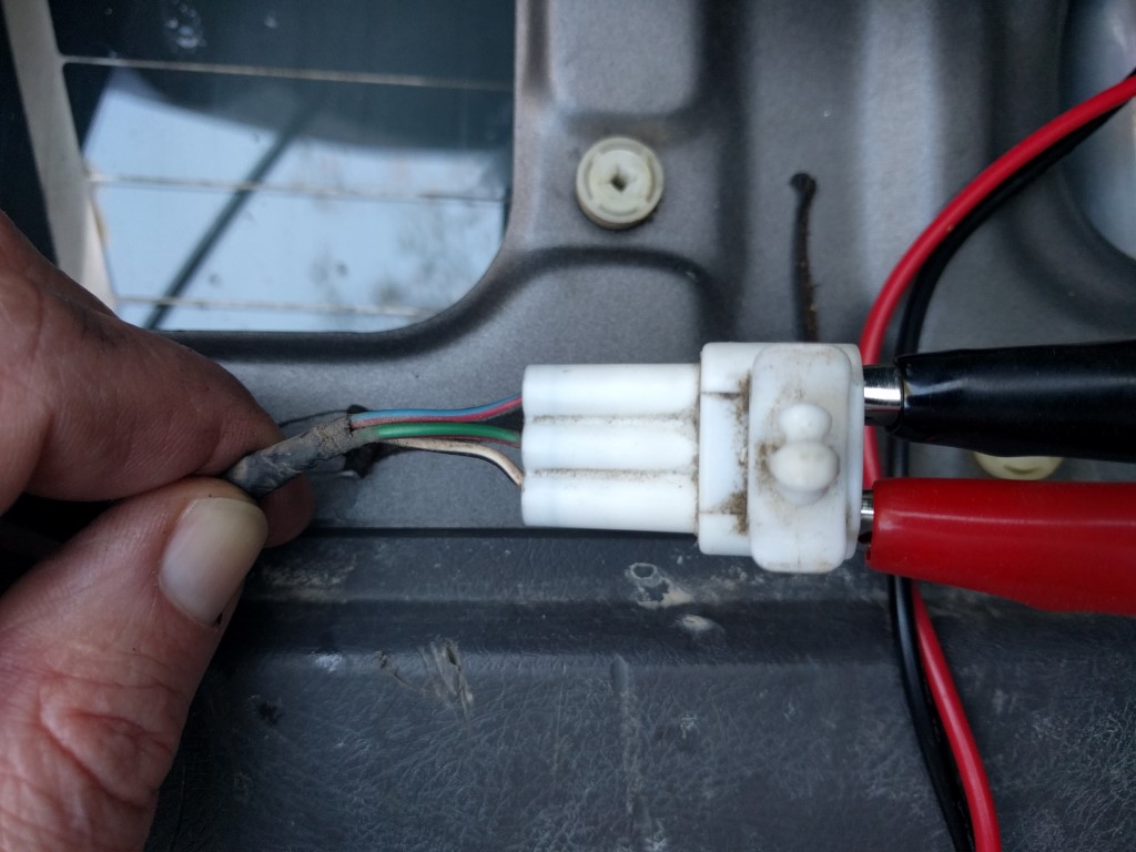

If you're having troubles with your rear window going up/down both with the console control or the keyswitch, check if the issue is the safety interlock on the left latch. When mine was intermittent, jostling the left side of the closed tailgate would sometimes affect the ability of the keyswitch to function.
If you want to test the switch, remove the inner carpet panel, then metal support panel, and then carefully peel back the plastic on the left side. Near there you'll see a 3-pin connector. The outer wires (red/blu and wht/blk) will connect/disconnect with operation of the left side latch. You can latch it with a large philips screwdriver, and unlatch by either then outside handle or tripping the release lever if you have the switch assembly removed. It's a cinch to remove it -- just three philips head bolts.
When operating the latch, you should get consistent ohmmeter readings when closed, and less than an ohm. Before fixing mine, it was all over the map and intermittently open.
My advice is if you have any intermittency now, spray that silicone spray liberally into the latch area and actuate the latch repeatedly to work it into the switch area. That should allow you to avoid entering the inside of the tailgate, but once you've done that a couple times, it only takes a few minutes.

On my 'Runner the release cable that runs from the middle of the tailgate to the LH latch mechanism got all bound up with rust inside the cable sheath. The rubber boots on the cable sheath ends were gone on that one, allowing water in. The rusty cable was stiff, and wouldn't retract back towards the latch upon release of the handle, thus holding the latch open. This prevented the switch from closing, interfering with the operation of the rear glass. Sometimes I could push in on the upper LH corner of the tailgate while operating the key to get the glass to go down/up. Replacing the cable with a good one from a U-Pull vehicle fixed it.

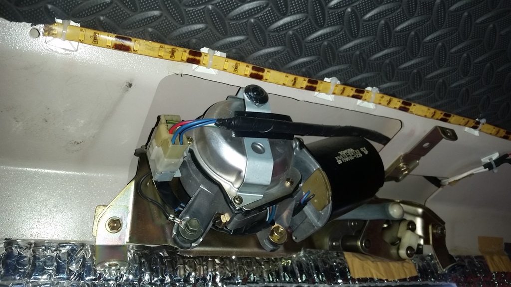

May I also add this quick and clean way to isolate / eliminate doubts on "rear wiper out of park" position (rear wiper retraction detection switch).
Disconnect this connector for rear wiper assembly. IF this solves the window not working, troubleshoot the rear wiper park position or switch.
