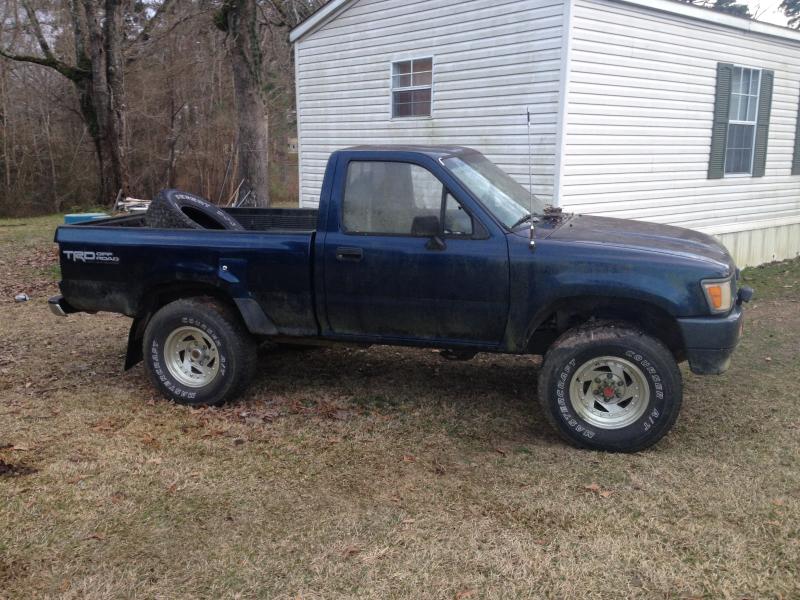

Picking it up tomorrow
92 22re 5 speed
Gonna run some 33x10.5's with bjs and either aal or longer shackles (gotta check the sag first). I had a 94 xcab 2wd years ago so im not new to yotas but new to the 4wd. Been around them forever but never owned one myself.

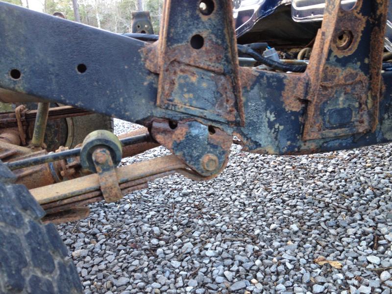

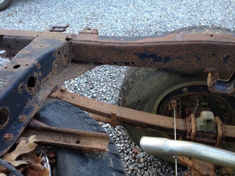

Started working and cleaning on it today i knew of a few problems but 1 turned out worse than i originally thought. Dang stealership got me with the itll be here tomorrow so no fuel pump hanger today. A few pics since we all like pics!
This was a truck from Illinois as you can tell by the rust everywhere!

Yikes on the frame rust! Wouldn't have guessed that it would be that bad looking at the body. Whats the plan for the frame rails?
Welcome to the forum!
Regency Mar 7, 2015 06:41 PM
Going to look around a little for another good rear frame section to section in. If i cant find something then ill template it and cut the rot out to try and slow that part of it then plate it and blast and paint as much as possible.
Yea the body is solid. I found some rust on the bottom of the doors but its not major yet. Tailgate is ate up pretty bad at the bottom all the way across so im not sure what im going to there just yet

Wow that is a suprise! Body looks so good compared to the frame!
If you cant find a good section, and know how to/have access to a welder, then some flat iron, and angle iron could be your friend! My cousin and i repaired a frame on his old Woody Wagon, and had great success, lots of cutting/grinding... But i would say the parts we patched up are stronger than the original ever was!
Good luck! Other than the frame, your trucjk looks great!
Regency Mar 8, 2015 08:11 AM
Yea i can do the welding a d have access to a mig. A friend up the road has his own shop and has a heliarc machine also. I have all the tools to patch it but id really like to find a rear section to just put in.
