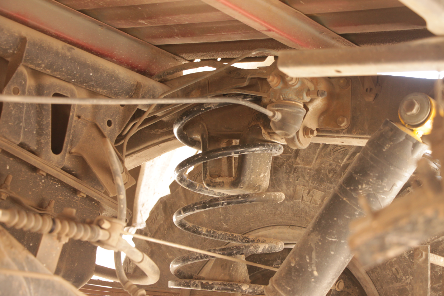

Just last week I did a Zuk mod for my truck (1994 4wd xtra cab, 22RE) in a slightly (or radically) different way from what I've read on various posts about it.
Instead of going the other brands coil springs way, I sourced a pair of 2nd gen 4Runner rear coil springs and used those, as I figured, both my truck and a 4runner have simliar vehicle weight. My truck wasn't sagging, but my objective was to slightly increase somewhat its payload capacity and minimize rear sagging when hauling heavy stuff. In short, lend it a hand when hauling.
So those 4runner coil springs, we cut 1 1/2 turn off each of them, and simply positioned them (while having the truck lifted on a platform) between the leafs and the frame, without needing to compress them. When lowering the truck, its weight compresses them and keeps them in place.
This way, the truck gained aproximately 6 cm worth of lift, which I wager is exactly what I'm substracting of sag when loading it up. I'll later post a photo to illustrate visual results.

You know those whoops in the road that if you're not watching give you a bit of a butterfly feeling in your gut?
What do you think happens to this spring you placed between the axel and frame when you hit one of these?

Nothing. The tests carried out until now indicate it will likely stay put. Let's hope it does.

It's a way too small spring or he wouldn't have been able to just slip it in uncompressed. This means when the frame floats at the top this too short spring is just floating around and is hopefully holding onto one of the bump stops.
There are lots of ways to do a good Zuk-mod, but this isn't one of them.

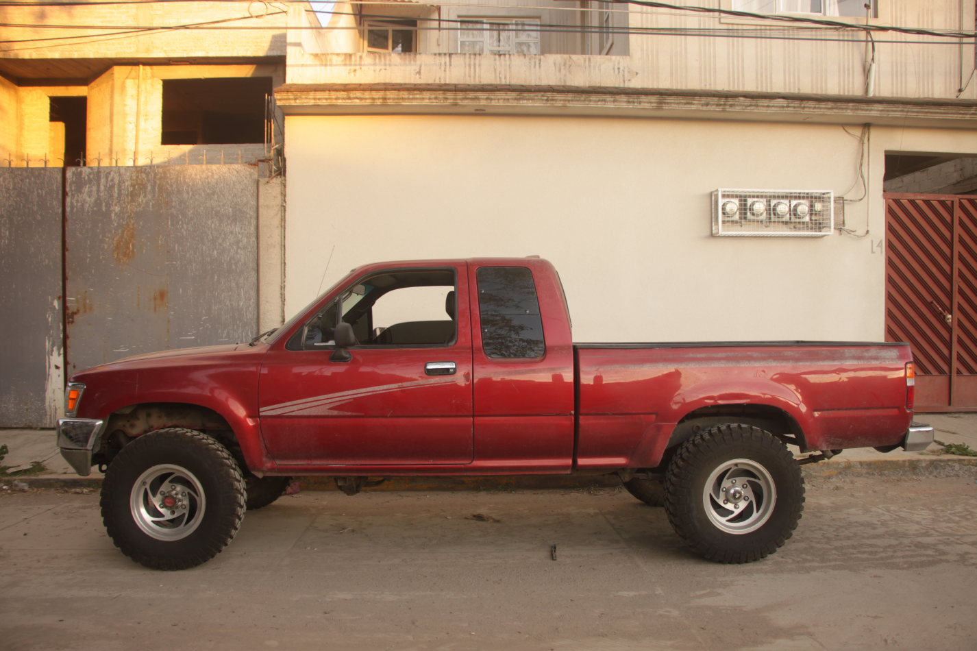

Well, those coil springs worked flawlessly during a +1000 km road trip, carrying +650 kg on the truck bed, truck barely sagged an inch. Without a load, truck is even front and back:
BEFORE:
NOW:
However, after unloading the truck, there has been "some" evident floating around (they probably haven't uncompressed fully), but only from the lower part of the springs (where they sit on the leaf springs). Everytime I've stopped to check, they sit perfectly where they sat just after installation. So probably, they are only bouncing a bit at their base, as the upper part is firmly held around the top bump and the frame.
Here are some photos:
As can be noticed, we had to somewhat bend upwards the lines just above the end of the passenger side spring coil.
Now, I'm not saying this is the safest way to do the Zuk mod, but I seriously doubt it will ever "pop out". As I stated, we drove more than a thousand km at highway speeds with heavy load; we already drove offroad without any load, and it only bounced somewhat in the way I described. I'm just sharing my experience on using a pair of 4runner coil springs for a Zuk mod.
