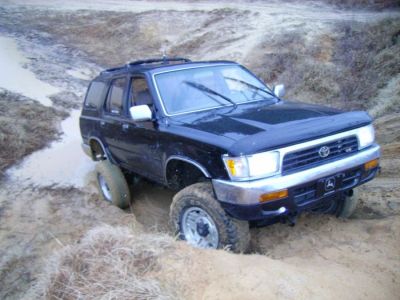

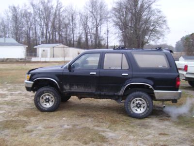

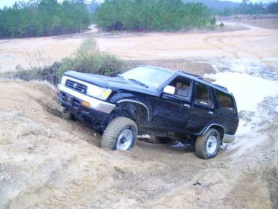

for yalls viewing pleasure, here are some pics of my new 4runner. yall got any ideas wut could be wrong with it?
-Kyle
