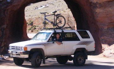

I have a thule rack that is secured only to the cab part of my 4Runner. I carry my bike on top along with my skis. Works fine.d
Attached Thumbnails Possible to mount a roof rack to a 1st generation without drilling holes?-red-rocks-bike-top-2-.jpg
