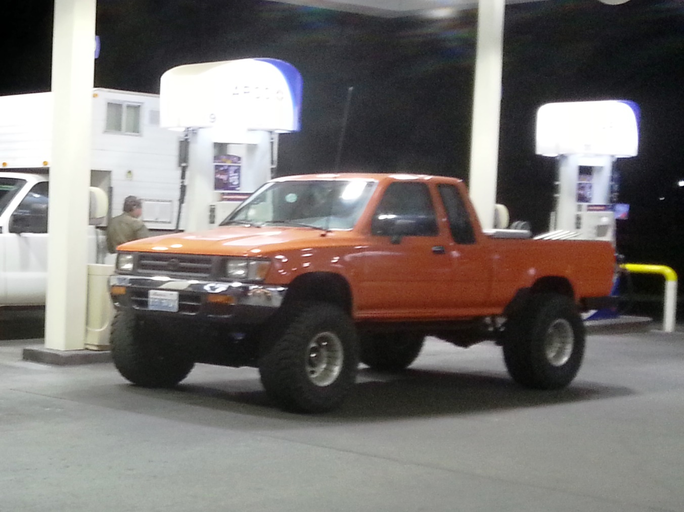

I bought an old rough 1992 pickup a couple years that was primarily used for wheeling by the previous owner (awful shape at that time) and have been working on it as a hobby but ended up being my daily driver unfortunately.
So I went through the front end and lift and fixed a bunch of stuff. From uncranking the torsion bars (now flat) to new TREs, control arm bushings, idler, ball joints, etc. and New Bilstein 5100s. The steering is much better but still rides like ˟˟˟˟. Especially in the front.
I am really trying to get a decent ride out of it as its my only vehicle and refuse to sell it and get a commuter car. Just dont want to be beat to death in it every day.
What can I do?

Just looking at the picture, I can tell your rear springs are flat and the front suspension is swagged out.
You're riding on the bumpstops, all of them.
Changing shocks will not help this issue. It'll just wear the shocks out quicker.
Replace or repair your springs, they are what hold your truck up on the suspension, not the shocks.
The shocks stop the truck from bouncing around like a bowl of jello on every bump. They do no help support the weight.
If you want an improved ride quality, get a set of 63" chevy leafs. Check out on pirate4x4 how to install them. Great upgrade for these trucks and costs very little.
Crank the front to match the rear once the 63" chevys are installed. Or get some Old Man Emu torsion bars. But I'm sure the old ones will work for ya.
