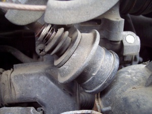

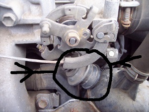

Hello. I just bought a 94 4wd pickup, 22RE and it has a high idle, all the time (cold, hot, makes no diff). I am wondering if some can identify the part I have pictured here. It is attached to the throttle body, and the throttle linkage sits on the pintle.
I am wondering if this part is adjustable, because it seems to be holding the throttle plate open, thus the constant high idle.
Any hints would be great, thank you.

That's the dashpot. It's a damper for the throttle plate so that when your foot comes off the gas, the plate doesn't snap back closed. Has something to do with emissions, and probably helps keep the throttle plate from wearing out.
In your second picture, look directly above the V in the left hand arrow you drew. There's a little set screw and a jam nut. Try loosening the nut, backing out the set screw a few turns, and then tightening the jam nut back down. The set screw contacts the dashpot plunger, so backing it out will make it contact the dashpot later.
Also, it's possible that the dashpot has gotten plugged. I believe they are expensive, so you might look in a junkyard or ask around on this forum. In the meantime, you could probably get away with simply removing the set screw and running sans-dashpot for a while. Shouldn't make a big difference.

It's called a dash pot (like others here have said). It prevents the throttle from "slamming shut" when you get of the accelerator to shift, also helps keep the rpms up for a second or two between shifts so it will help on the highway to maintain speed. It does get clogged over time. There should be a small hose attached to the back end of it with a small "filter" on it, the filter gets full of stuff after a while. My advice? Pull it off and see if the problem persists. You can eliminate it by adjusting the set screw that RustBucket mentioned. I eliminated mine years ago since it was easier than finding a new one. No issues that I can report other than an instant drop in rpms when I get off the skinny pedal to shift.

Yeah, good luck finding a new one. I had to buy and entire used TB for ~$90 when I melted my dashpot years ago ("minor" engine fire) since no one anywhere could sell me just the DP. Definitely affects idle. My 3.0 wouldn't stay running without the set screw cranked way out and still idled inconsistently after that even. Looks like you've got plenty of adjustment left though.
