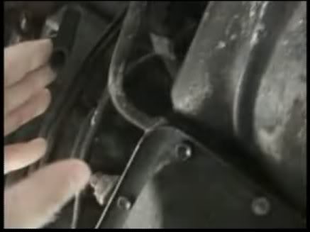

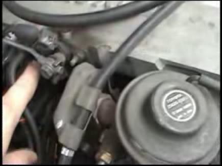

hi
i have posted a youtube video 2 show my multiple problems i dont know how to fix
http://www.youtube.com/watch?v=uedpjdWdYmc
[YOUTUBE]http://www.youtube.com/watch?v=uedpjdWdYmc[/YOUTUBE]
i dont know what 2 hoses are used for and trying to stop an oil leak
you will see my problems by watching my you tube video

No, don't connect that rubber hose to the metal pipe! The metal pipe is the drain for the AC. The rubber hose looks like the drain for the charcoal canister (evap can), normally that hose is pushed into a hole in the frame. Both are meant to be open to drain fluids.
The round thing next to the oil filter is the oil cooler.
The leak could be from a rear main engine seal, or maybe the oil is leaking from in front of that somewhere and blowing back as you drive. Hard to say.

now what about that hose hooked up to the engine (maybe a vacuum hose) if that is leaking or bringing air in the engine what will that cause my engine to do
for that oil leak i was thinking about buying lucas oil stop leak stuff

The hose that is hanging down kind of on the drivers side looks like the overflow hose from the coolant reservoir. If you look down the side of the reservoir there is a hose that just hangs down low.
The diagnostic port is supposed to be full of that "goop". I think it is a non conductive grease to stop corrosion and rust on the connectors.

If you have an air leak than you truck will run rough, and will be idling too low, as for the dripping, its most likely a gasket, if its ahead gasket do it your self, it saves money and time, it should only take 30 minutes. The hanging hose you should definetaly find out where it goes, if there is only one possible hose hole that it could go to, well then common sense tells you thats where it goes. feel the inside of the hose for residue, if there is oil than it connects inside the engine and should be easy to find, if there is no residue than it is an air hose or gas hose, however it cant be a gas hose because then your car would not run, it does run right?

i think the tube on the bottom is the drain for your rad..
also the gunk should be there and the oil is it leaking alot or just a little??

On the possible vac leaks, you can take a can of carb cleaner or something like that and while the engine is idling, spray near the vac line. If the idle changes then there is a vac leak.
The oil leak could also be something more simple like a valve cover gasket. Try to get a look at the back side of the engine (hint use a small flash light) and look for oil up higher. Generally you can't tell alot by looking at the drip point, you need to follow the "wet' trail up to the source. Are you sure its oil and not ATF? It looked pretty black so it probably was engine oil. Might try changing your oil if it is black like that.

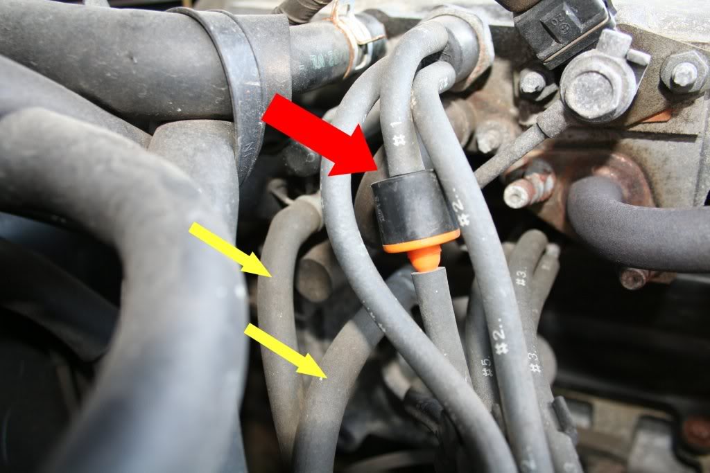

The first hose you pointed to does not seem to exist on my truck;
My truck;
The yellow arrows point to the two vacuum lines that go down to the Power Steering "Idle Up" switch. The Red arrow points to the hose that does an immediate 180° and goes to the PCV valve on the RHS valve cover.

The third issue you are addressing, the oil leak, is quite normal for the 3VZE engine. 80% says it's the rear main seal. They weep... that's it. Removal of the transmission is required to change it. The dealership I worked for charged 6-7 hours for that $5 seal. Not sure if it's worth it to you. Also, if it's out and you're a 5spd, I'd recommend resurfacing the flywheel and replacing your clutch since you're paying for the labour anyway.

If that vacuum line runs down to the power steering pump, it's the idle up for the pump. So the engine RPM will go up when the pump is working hard. I broke the sensor on the back of the pump on mine, so I just capped the nipples on the engine and removed the hoses. Less clutter and I have not noticed a difference.
The other thing it could be is the idle up for the AC system. Same idea. AC turns on, RPM goes up. I would not cap those. Just pick up new lines at any auto part store.
