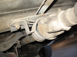

2ND question was about what I call the carrier bearing which is the rubber part half way between the drive line that attaches to the bottom of the frame/bed.
Attached Thumbnails Play in pinion....should I try to fix myself?-img_7695-smaller.jpg

Well the less play, the better. My experience with these is that the aftermarket ones don't last very long at all.
As long as its bearing is good and the rubber is not broken out, it's probably OK.
