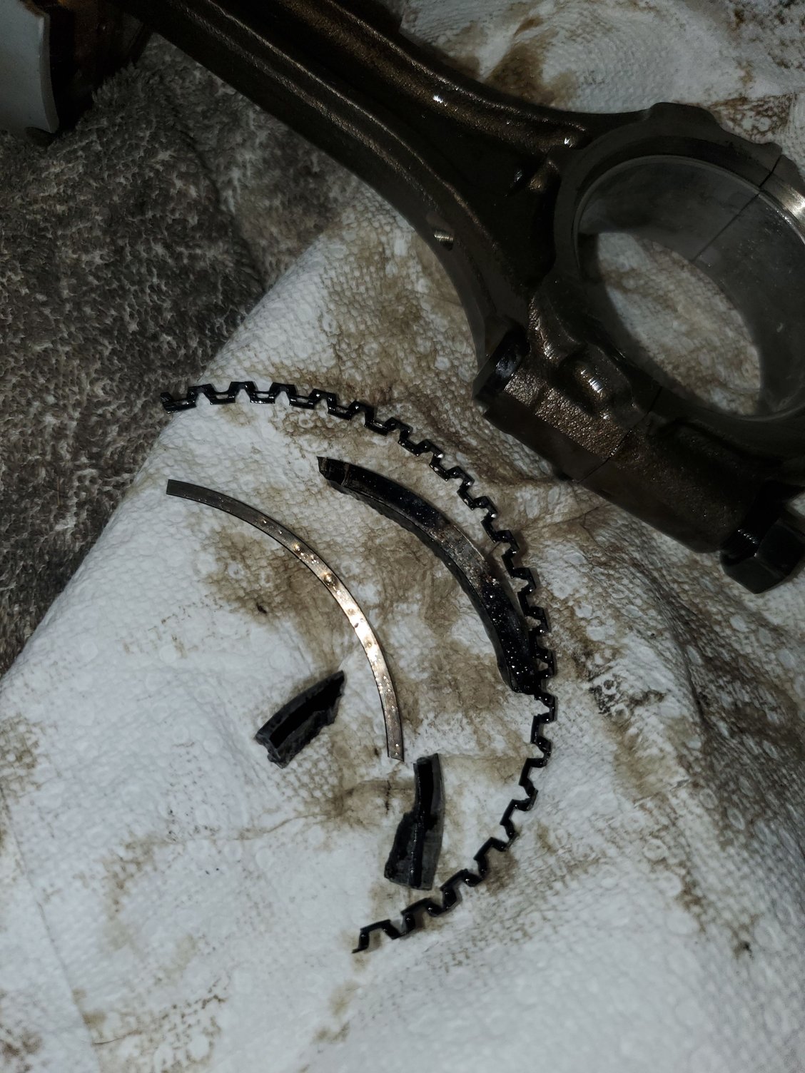

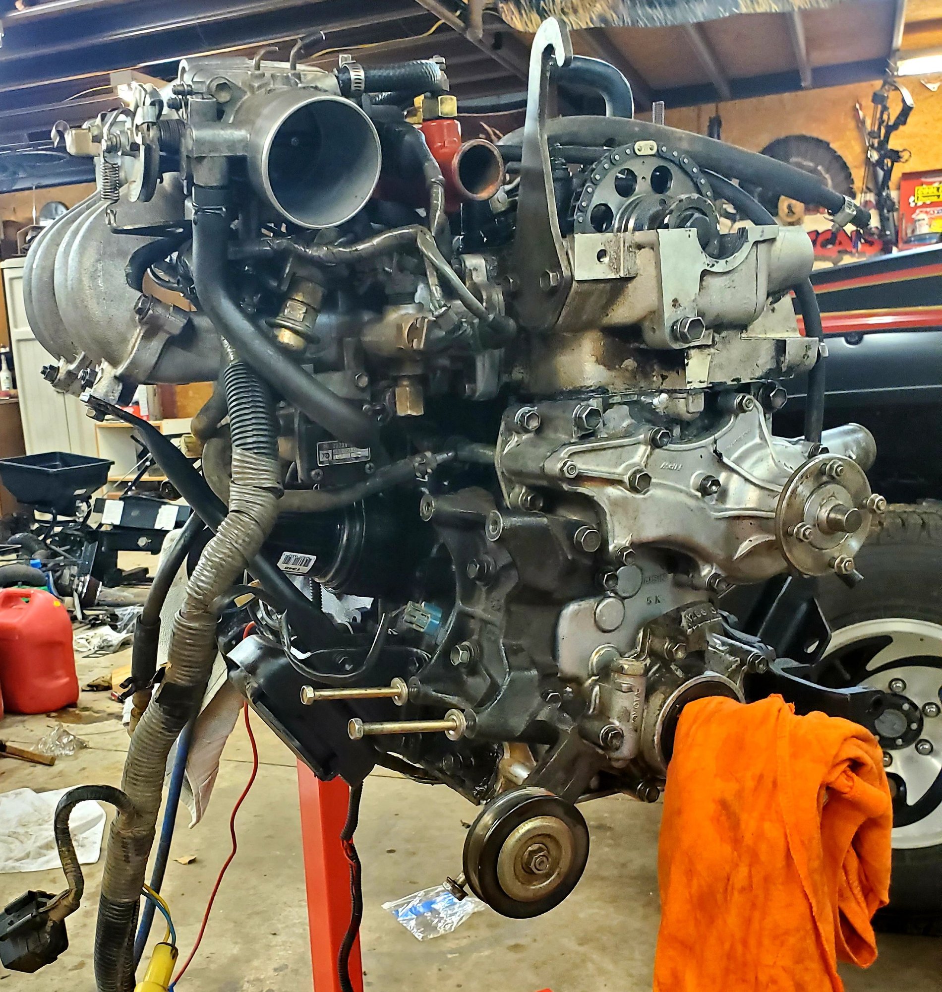

Well I've only put this off for about 5 years. Finally got the finances and desire to to get r dun.
pulled the motor. Took about 3 hours just piddling around.
Found my by pass problem...

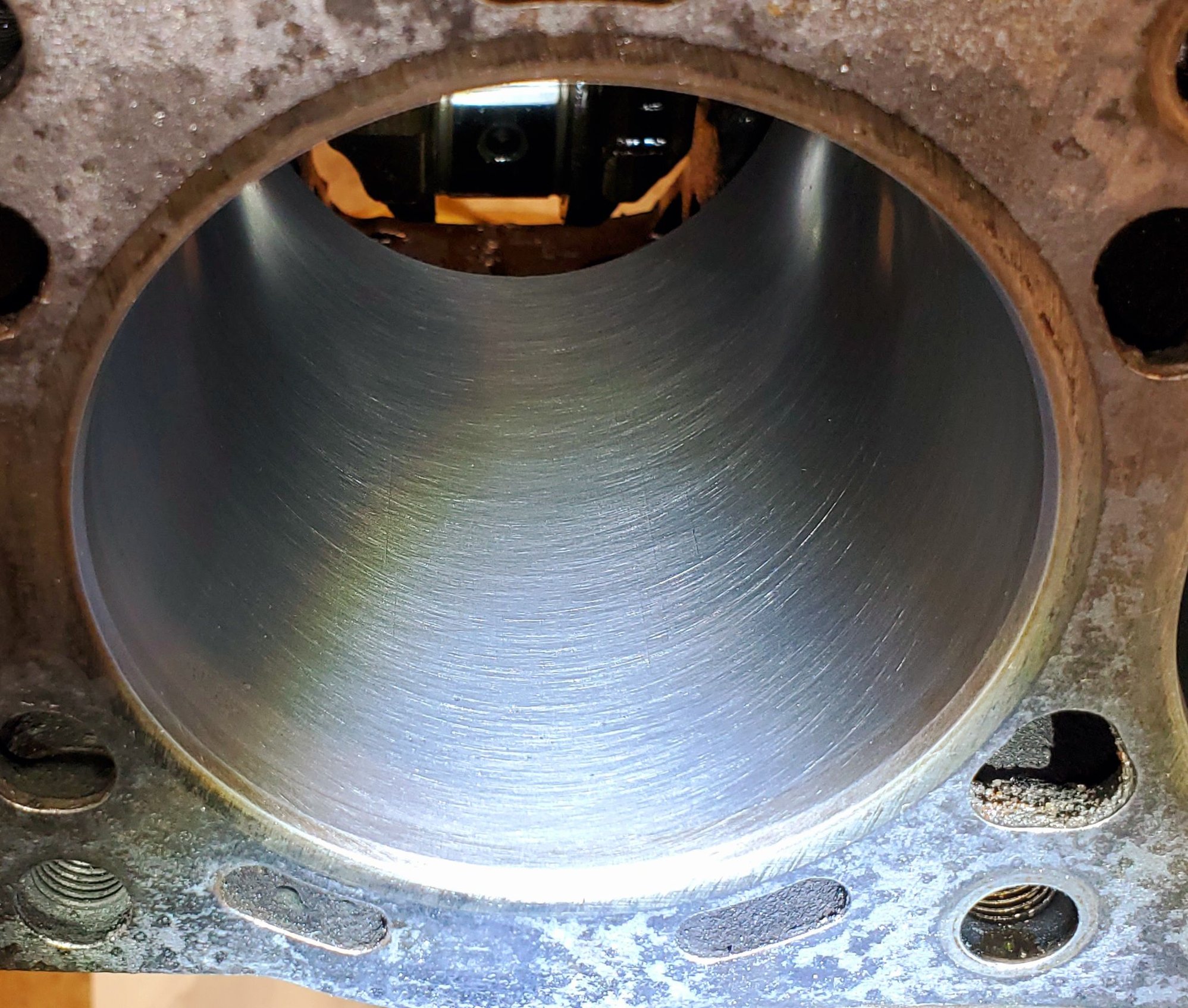

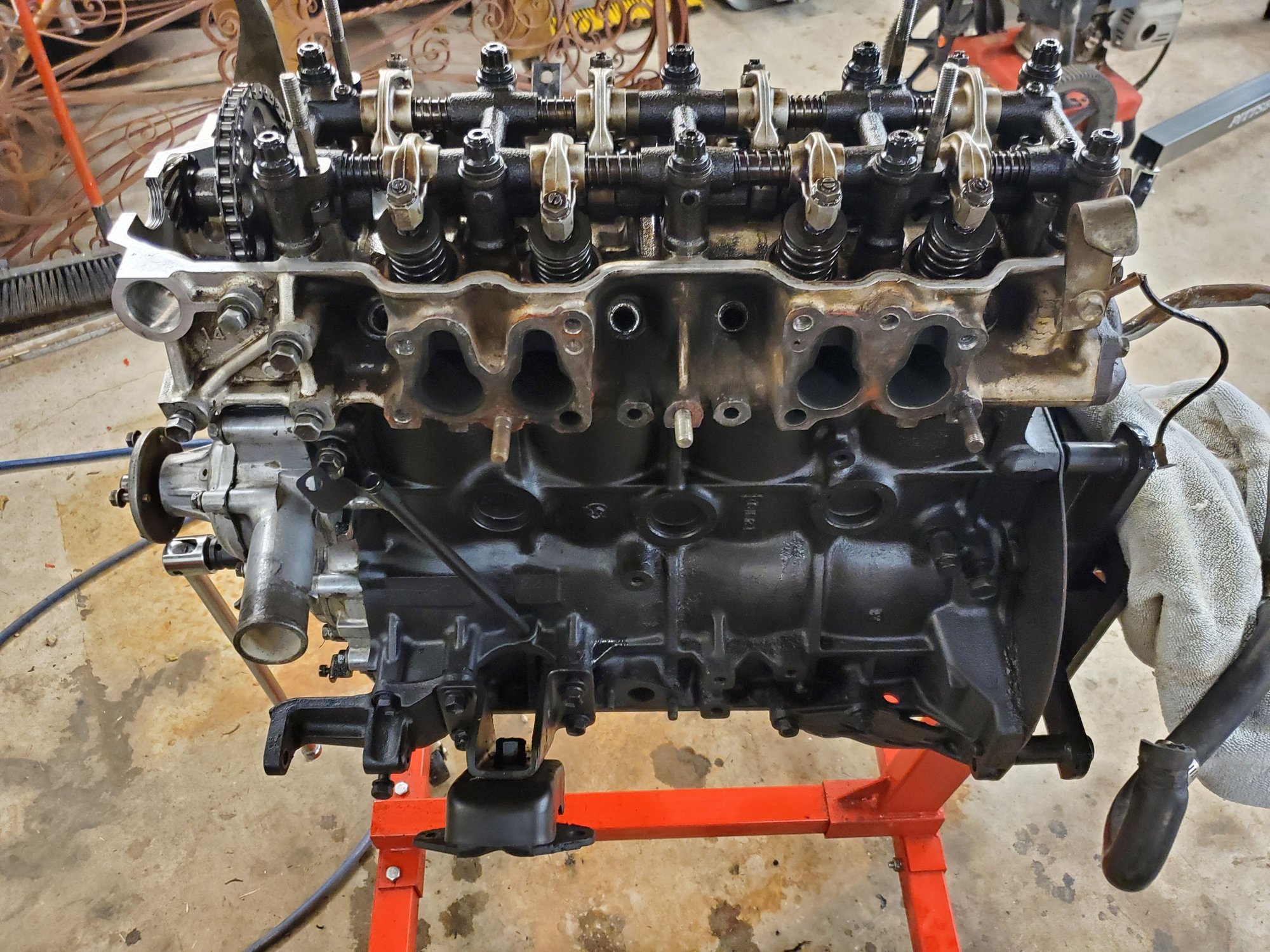

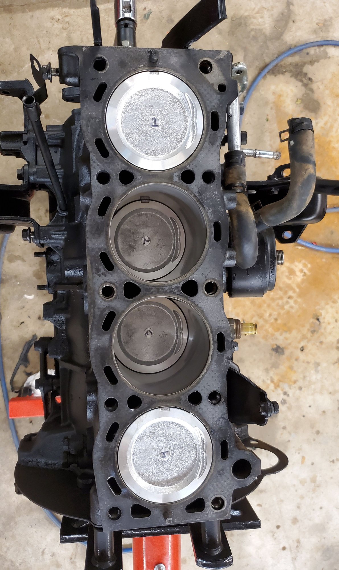

Honed cylinders with a Flex 4"
25 passes using marvel mystery oil for lube. Got a nice clean, cross hatch pattern.
Ordered new pistons and rings from LCE
Standard bore.

Cleaning and painting parts, supposed to get a complete 22rte gasket set from LCE tomorrow. I can start assembling the rest of the motor then.
No boring, no decking, everything was in really nice condition so I'm just going back to standard, with the exception of the CT26 turbo upgrade. Going to take the ARP studs from this motor and use them in the white 4runner I'm keeping. Getting new head bolts for this motor. Trying to do it right while keeping cost down, because I'm selling this red truck.

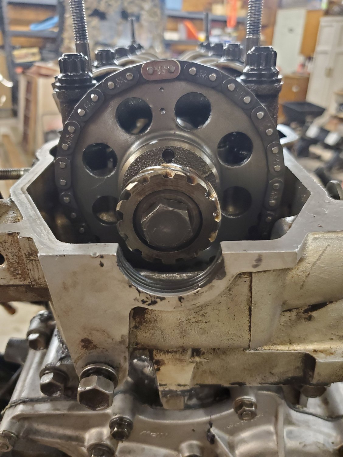

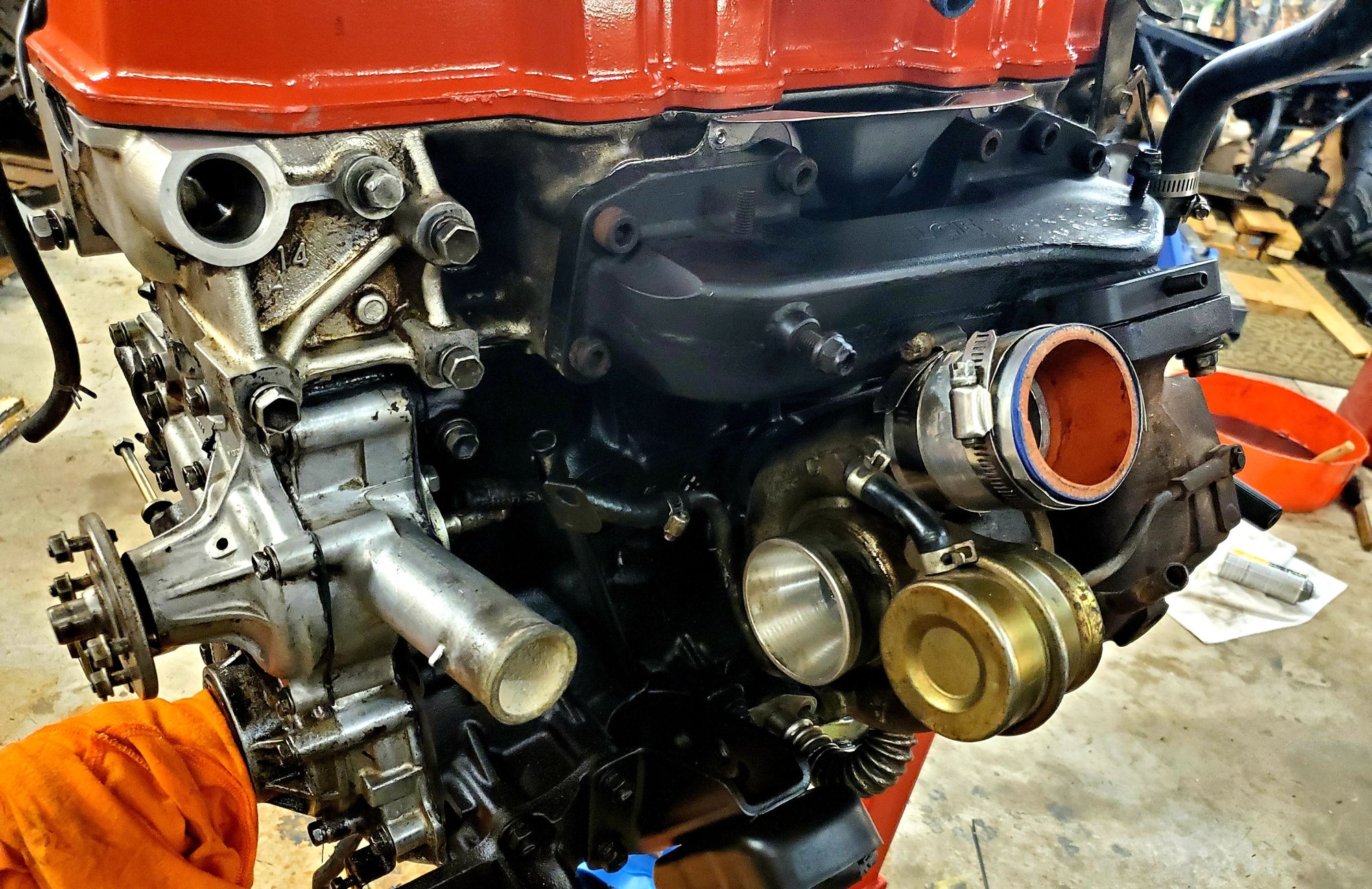

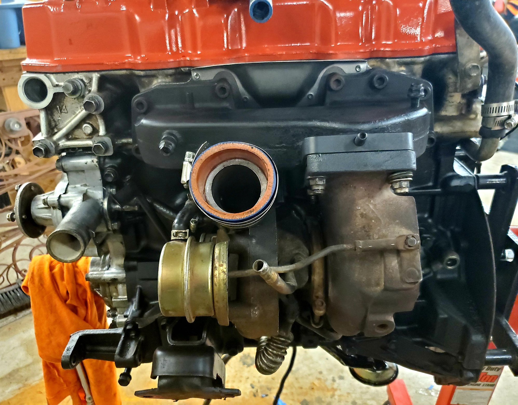

moving along...

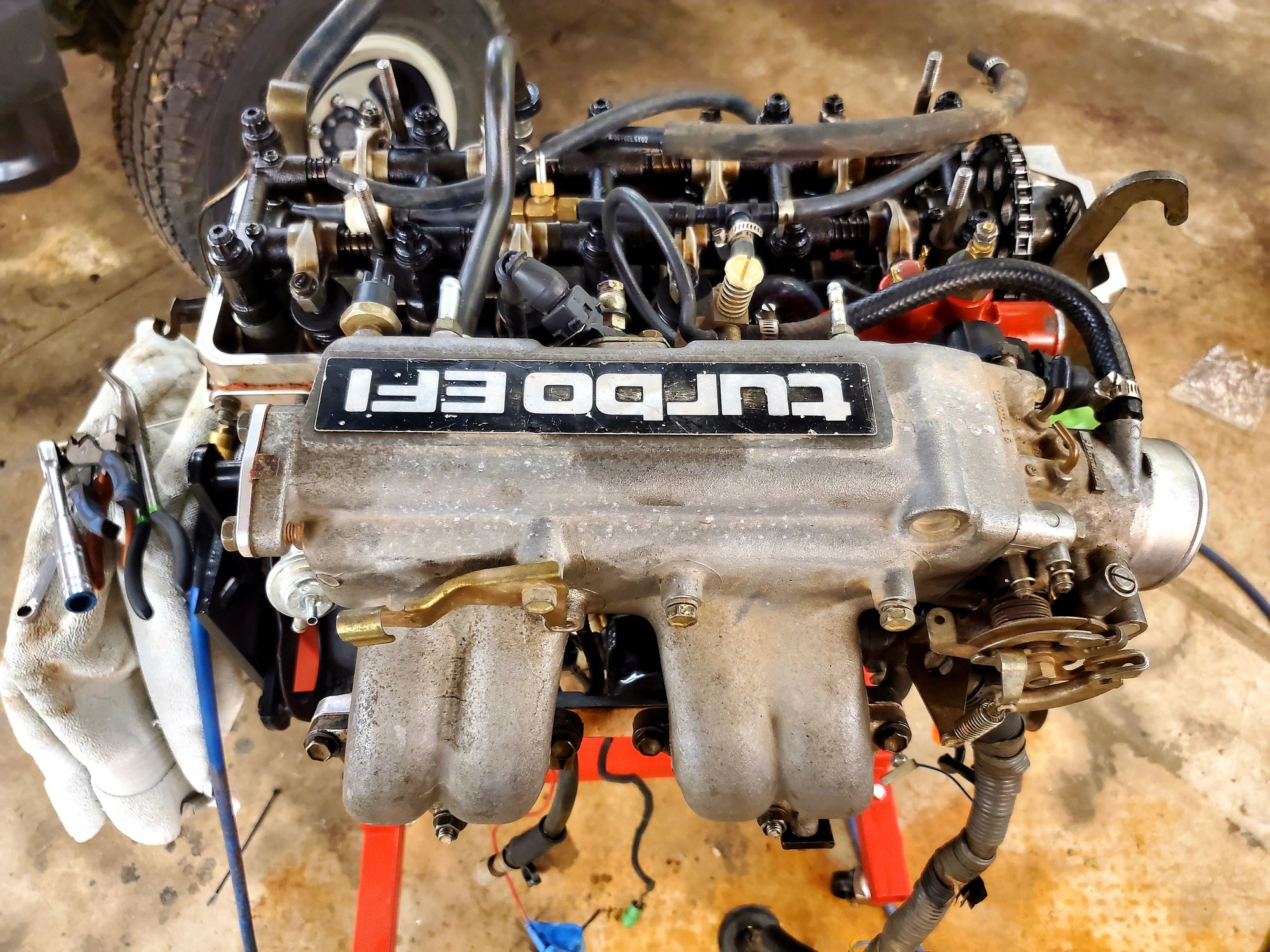

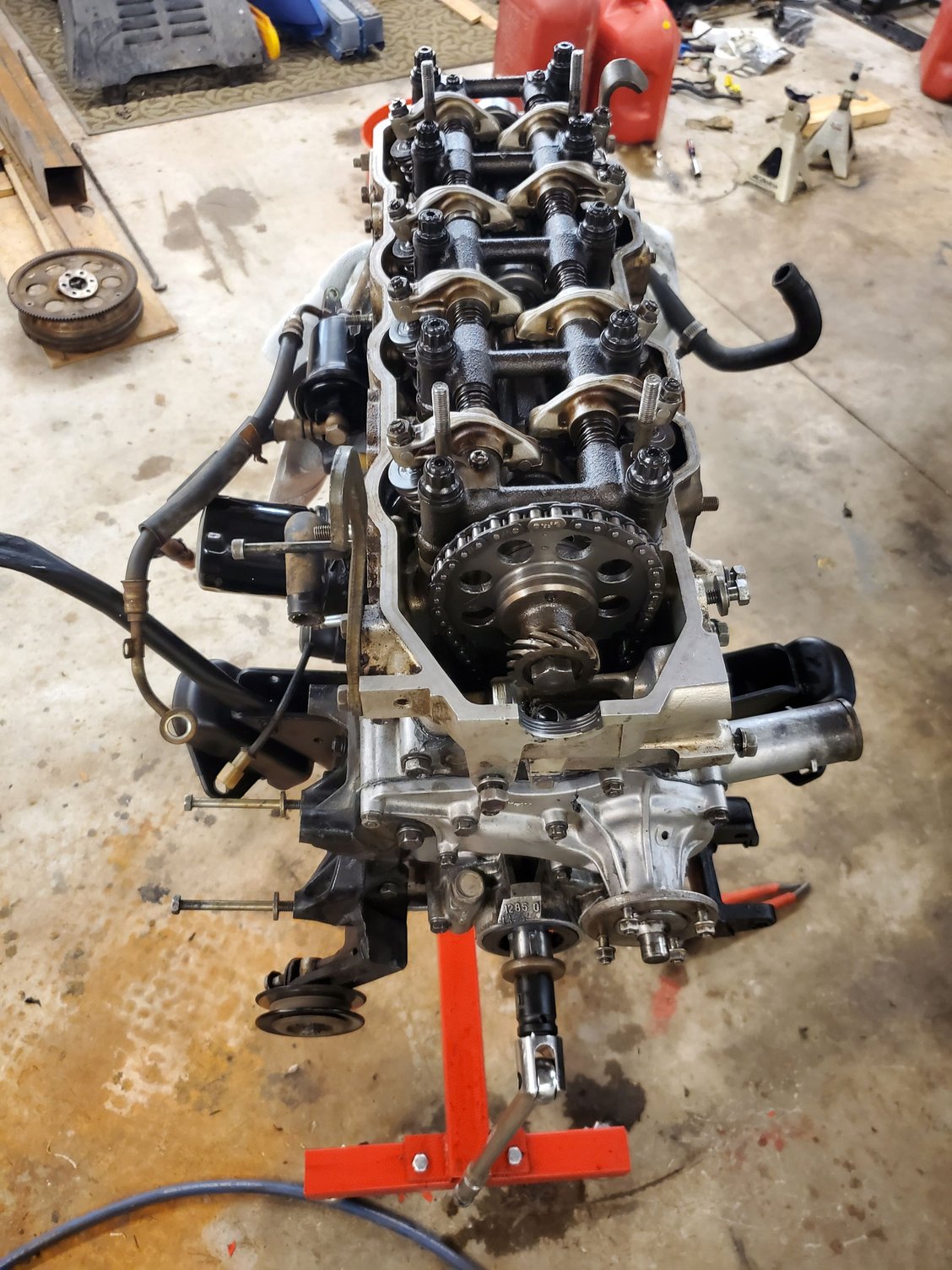

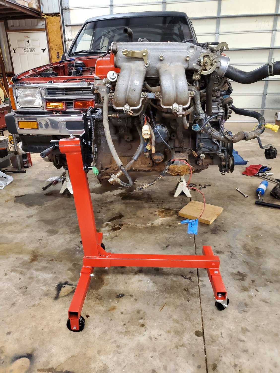

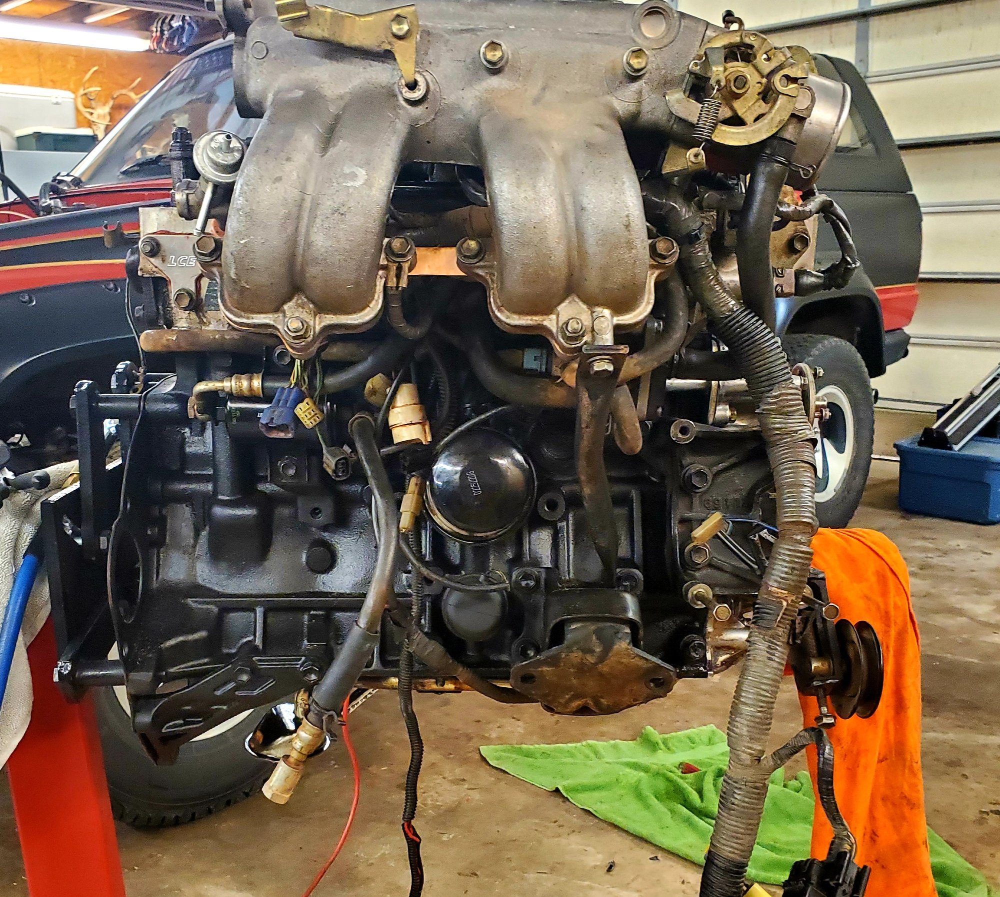

got the intake manifold, fuel rail, injectors, and plenum back on.
Woohoo

Amazing how great a job you can do on installing parts when the engine is on the stand.😀👍🏼
Even the fuel filter is a piece o’ cake
Old May 19, 2022 | 11:51 AM
87-4runner's Avatar
Joined: Mar 2012
Posts: 1,139
Likes: 414
From: Oklahoma
I've done this both ways and I'll never do it without pulling the motor again.
You are dead on!!!

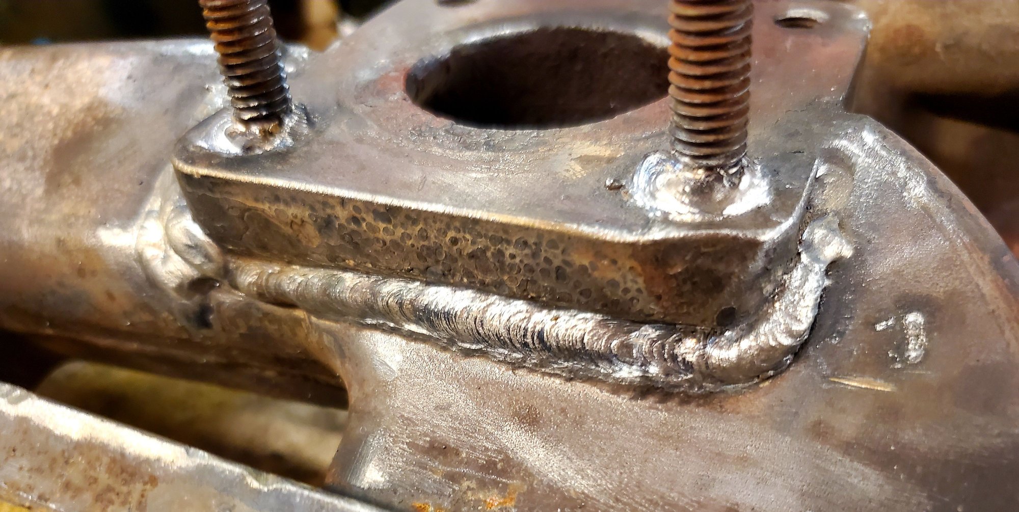

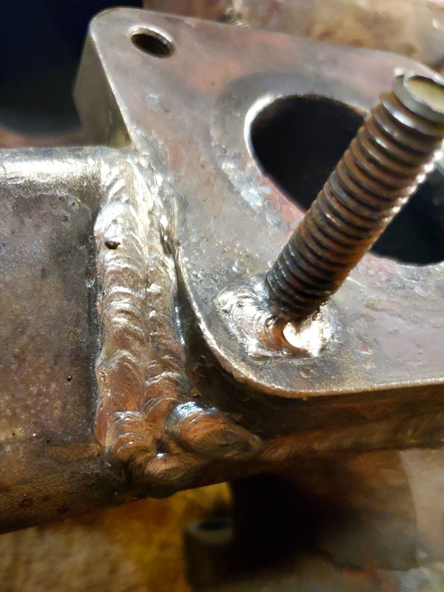

Got the$700 cracked LCE exhaust manifold welded. That they wouldn't make right.
Old May 23, 2022 | 09:36 AM
87-4runner's Avatar
Joined: Mar 2012
Posts: 1,139
Likes: 414
From: Oklahoma

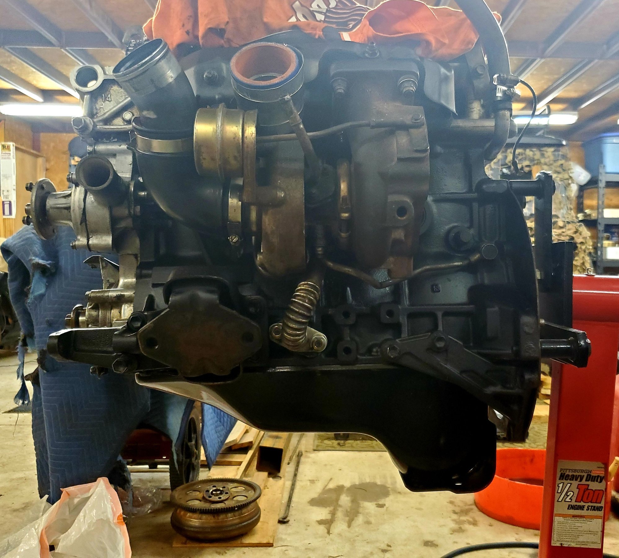

A little more progress. TURBO is on!! Just a couple more things with the motor. Slap on the oil pan and stick it back in. Woohoo

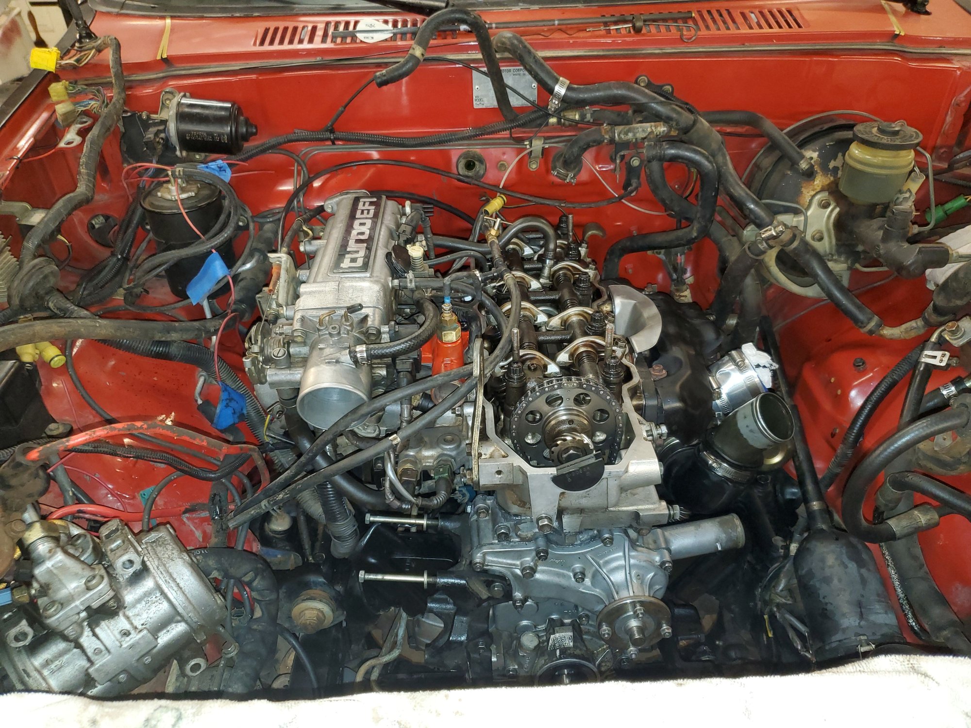

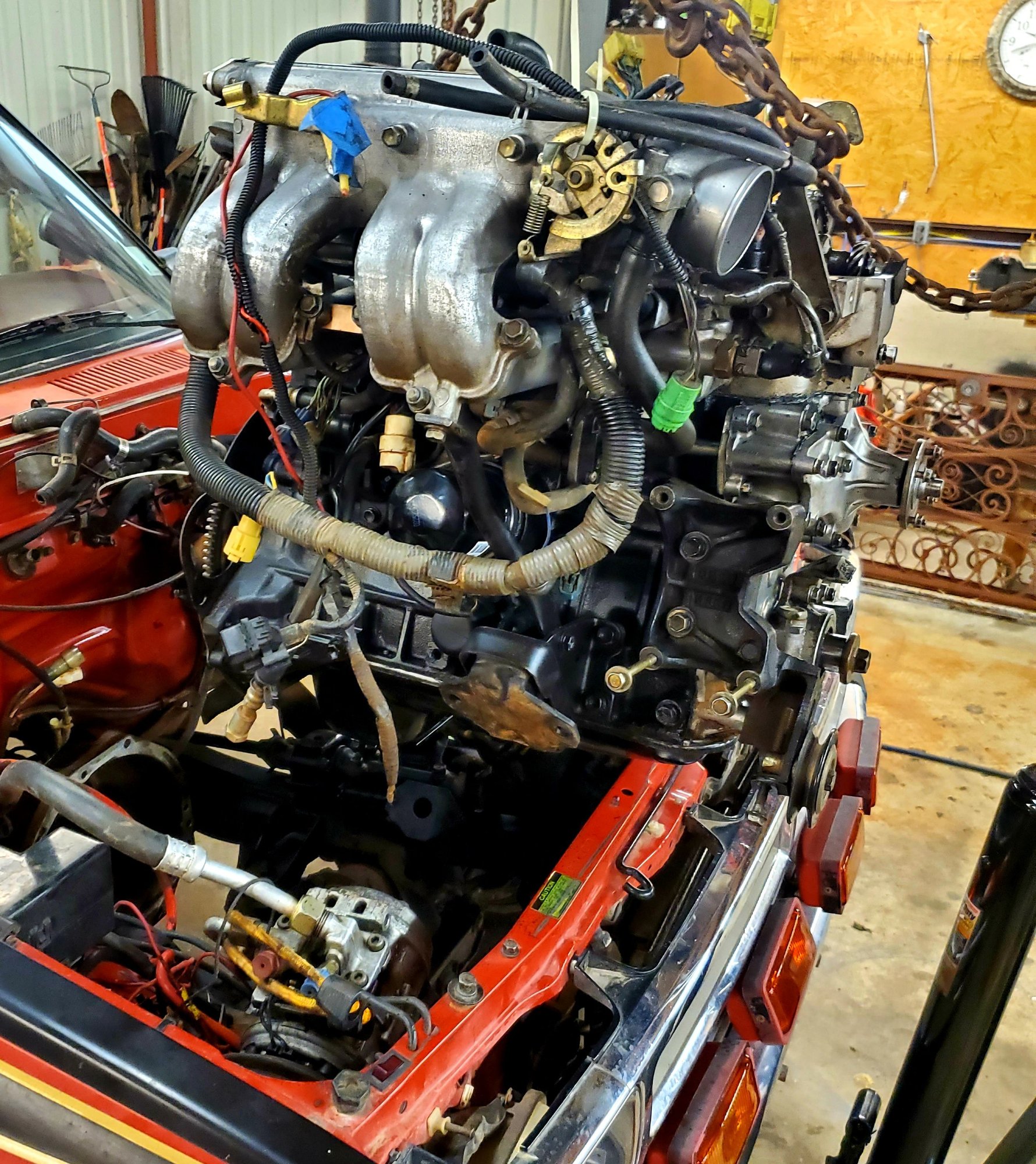

Going back in
was a little tricky doing it by myself.

Well I made a big rookie mistake.
put the spacer for the flex plate on the outside of the plate, rather than next to the crank shaft. Had to pull the motor back out and reposition the spacer.
only cost me about 6 hrs of work.
Good news is that it's back in bolted up and ready to install the A/C, alternater, stab the dizzy. Hook up All the lines add coolant, oil, and fire it up.
