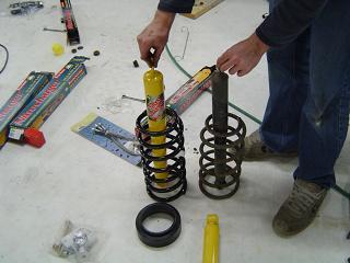

Here they are.
Pardon the perspective shot that my father took of the two (left=stock toyota shock/right=ARB OME N72F "long travel" shock) they are both fully extended. Though the right one looks alot longer, its infact three quarters OF AN INCH(3/4 inch) longer travel than stock fully extended. I need 3 INCHES not 3/4 OF AN INCH !
The last two pics speak for themselves. Fully extended, the new set up vs the stock set up.
OME shock/spring/coil spring spacer.
Notice the shocks are identicle in height? Where is the extra 3" of travel going to come from? LOL

That is the reason, us with the cruiser coils don't have OME's in the rear. They will work but won't allow you to use your new suspension to its fullest.
YOu could always try to swap them for ones for a fj80 or something, but not sure how stiff they will be. If I remember correctly, the ome shocks are matched for the coil not the extra spacer.

Well, if you're only asking if the rear shocks are too short for the 4" of lift that the rear springs and spacers provide, then yes, it appears so.
Having said that though, it may not be a problem.
The only way that you'll get 3" ~ 4" of lift in the front (to come anywhere close to matching the rear) is by cranking the t-bars up 1.5" ~ 2 ".
Do that and you'll kill your on road drive and you'll also pretty much kill any flex in the front.
That "lift" package, as it's sold, is more for looks than functionality..
So, if the front won't flex, because the t-bars are cranked so stiffly, then it won't really matter if the rear won't flex because the shocks are too short, will it .....

Those rear shocks will work but will limit travel. We have changed the number on the rear to use with the spring and spacer setup. It is the same as the LC. shock that has been mentioned. As for the comment they are junk (Yes the Pro Comps) from one of you and Bilsteins are better I would agree they are better than PC's but the OME are a very good Shock.
Send you daytime phone # to info@trdparts4u.com and Jacque will call you Monday and get them swapped out.
