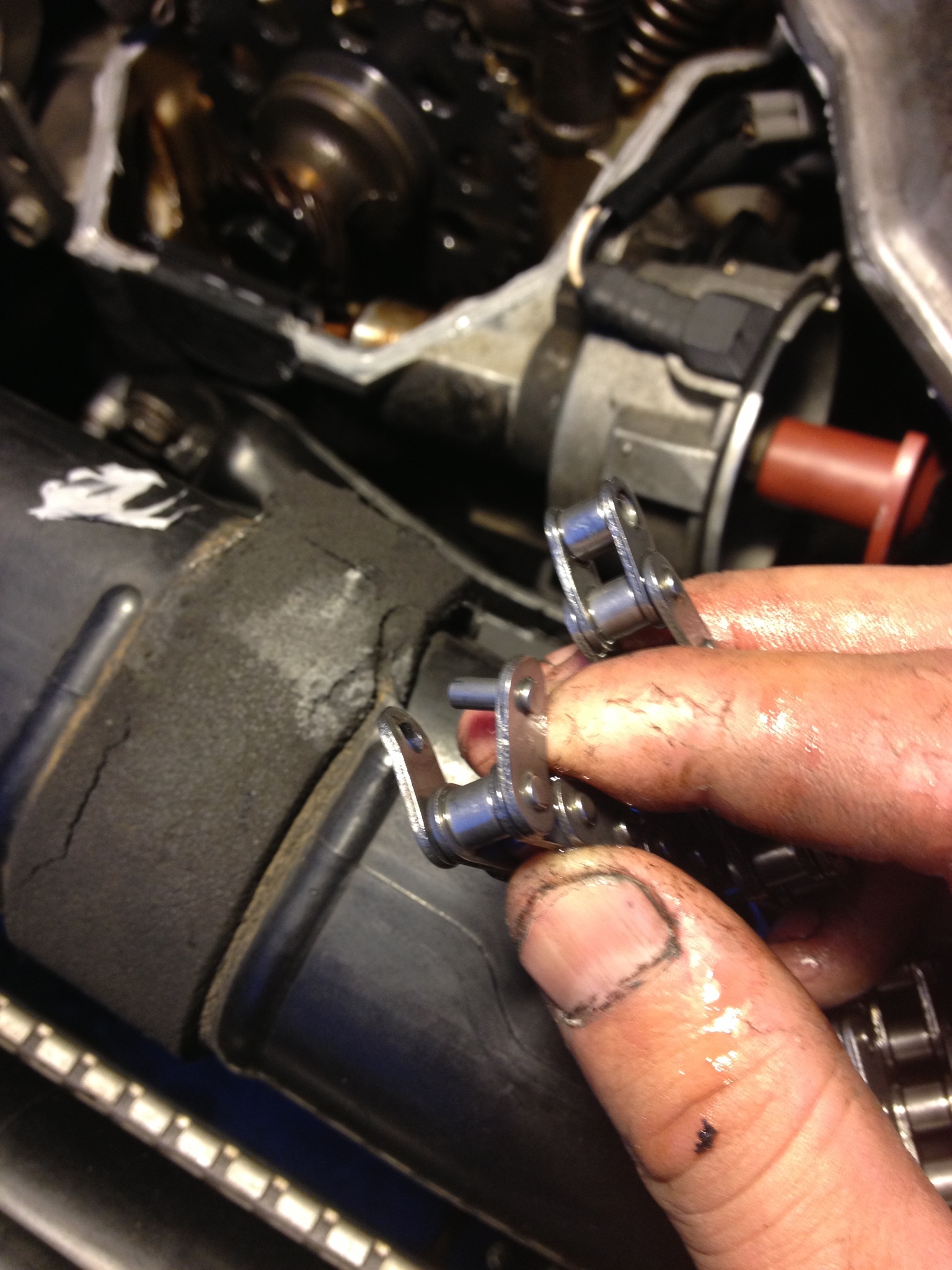

I figured it out. the timing chain that I just had installed broke. not even a few miles out of it. just a weird coincidence of the arc the same time the chain gave out. So yea I have to do the timing chain job all over again! ahh damn Cheap parts stay away from ebay junk.

here is the new one that broke
Attached Thumbnails OFF ROAD LIGHT wire arc and I'm an idiot, NO SPARK! I have checked everything-chainbroke.jpg

I am glad you figured it out.
Just one of those freak things that was unrelated to the sparks.
your lucky the chain did not jam on the crank sprocket .
