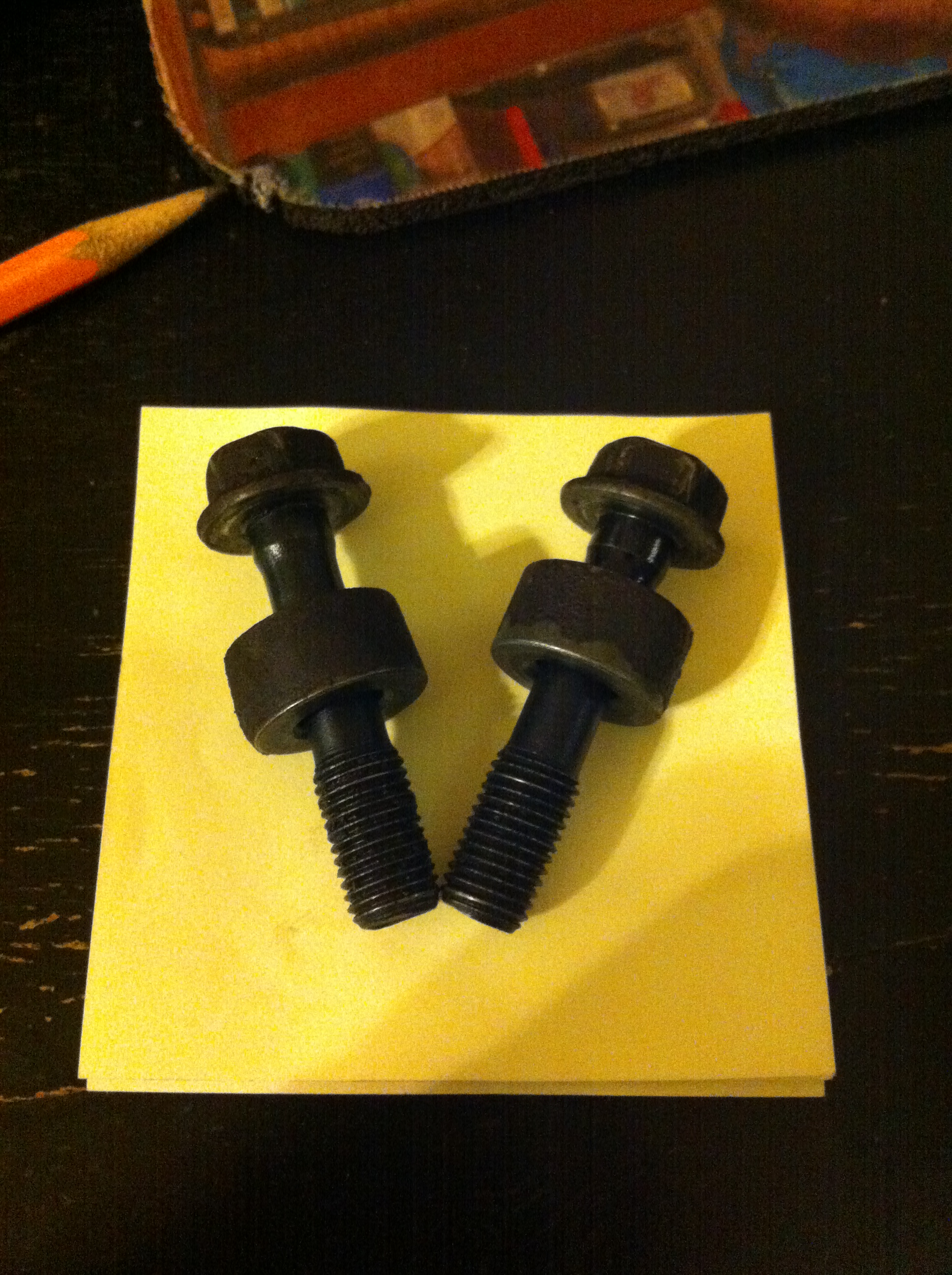

So I am putting my engine (3vze 3.0 v6) back in my 4runner and there are these two bolts that i have laying around and i don't know where they go and i don't want to get to far in to installing my engine and then find out that they go under a bunch of stuff so does anyone have any idea where these two bolts go????
Attached Thumbnails not sure where these go! PLEASE HELP!!!!!!-pictures-1-067.jpg

From first glance those appear to be bolts for the head. One on each head. I believe one goes at the back of the passenger head and one on the front of the drivers head. I'll try and find a pic.

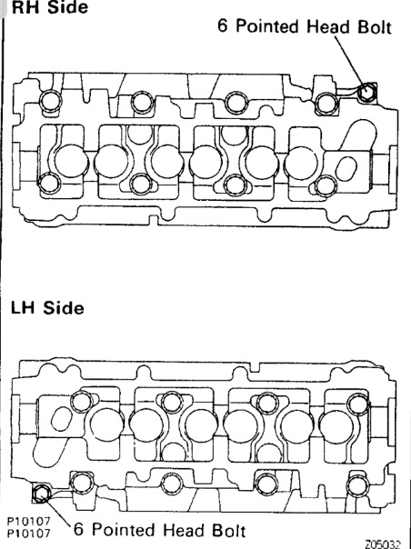

Locations are the 6point bolts below.
