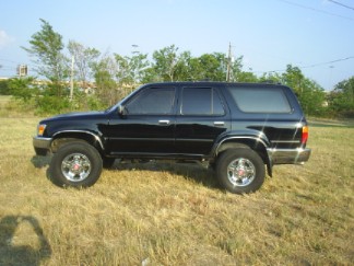

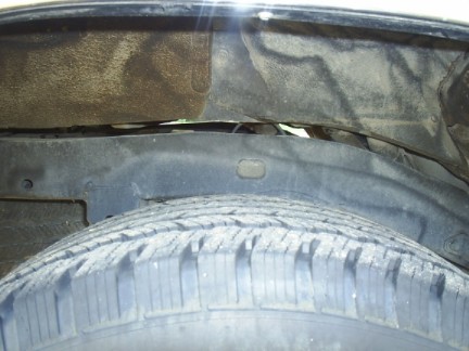

I am new the 4X4 side of Toyota and im hooked .....I have a 1995 4Runner and its taller than just about everyone that I have seen that are stock looking...It has 275/75/16 tires on it and i know that helps but it seems quite a bit taller...but i see no sign of a suspension lift it has a little sag in the rear ...and there is a small gap maybe .5-1 inch between the rear frame and the body but it dosent seem to follow to the frt of the body am i just going crazy or is there something else i could be missing...i plan on bring it up a little and i am trying to find out where i am now so i know which way i want to go....

the frt gap from bottom of hub is 25 inches straight up to fender and the rear is 24 inches
i have seen some with running boards i know it makes them look lower i ment by hood height when i parked next to a few...
also th prev owner said there was no type of lift on it...
the first pic the the rear frame gap
the second is my runner
the third is the cv angle
thanks for all the help guys

Purdy truck, it seems stock, but do you have trimming or rubbing issues?

They usually sit a little higher in the front, and I notice you are also on a hill but the back is still level.
There is a good possibility that there has been a leveling kit installed in the back of that truck... Maybe longer sprongs or spacers.
Looks good though...

The CV angles look pretty whacked to me ?

the car has 275/75/r16 tire size on lexus lx450 rims and i have mildly off roaded it they never rubbed i thought the cv angel was a a bit steep...i dont see any bj spacers and the springs look stock in the rear... iam going to get it in in the next week or so for the recall so they will align it again

You deffinitely have a lift, those tires are a bit over 32". Those size tires will normally fill the wheel well especially if the rear coils are sagging, and judging by the cv angle. Mine has no lift and is almost straight. You probably have longer coils and the T-bar cranked.

i now know the springs in the rear are stock and the t-bars are lifted a little...I just got a bj spacer lift kit and will be installing it when i get a few more things....new brakes, ball joints, and cv shafts.....
