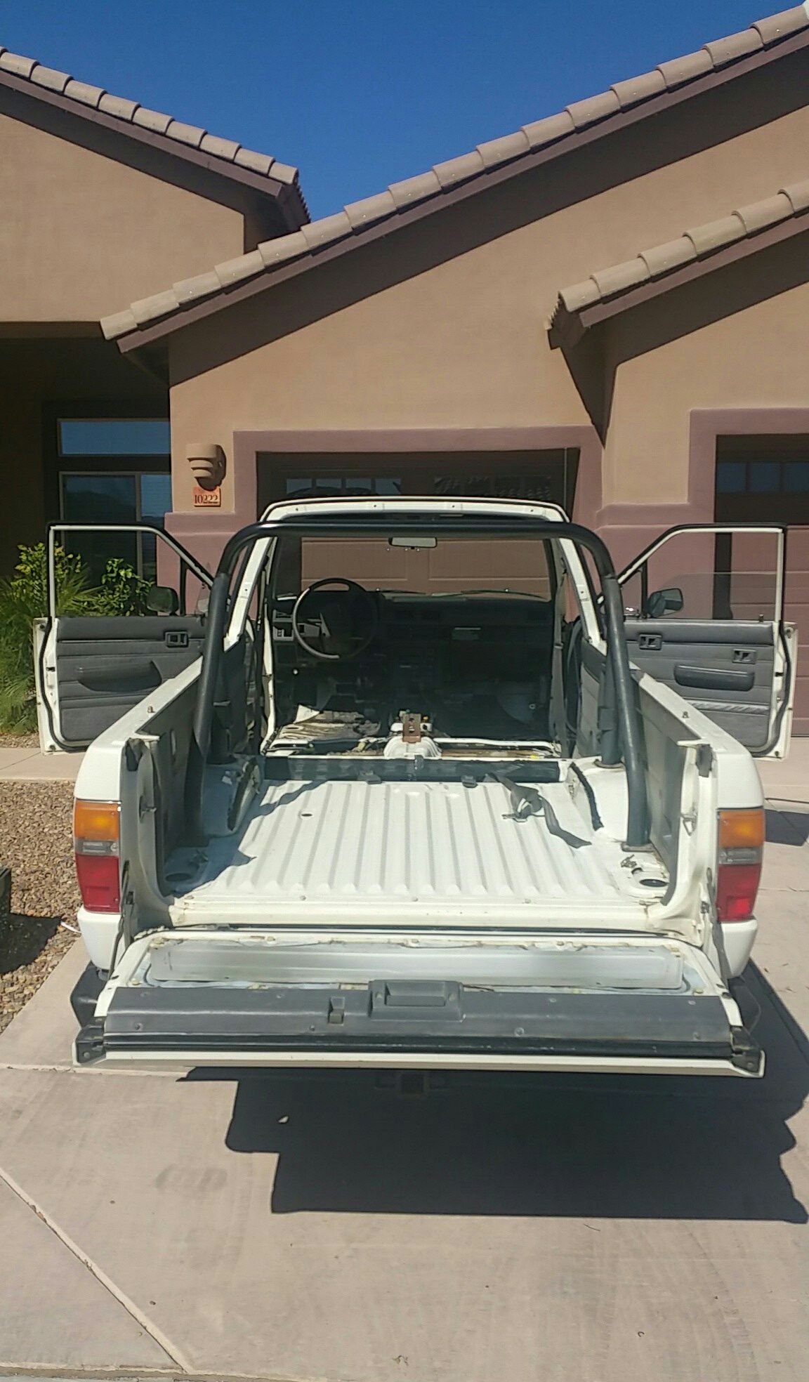

Recently purchased a 1988 4runner SR5 auto 4x4 from a family member. Its in great condition for the most part. But it's still nearly 30 years old. I wanted to make a thread to document my progress on the restoration.
This is a shot when I first brought it home. 202,000 miles on it. Rebuilt engine.
Pulled all the carpet out of the pack to clean.
Installed some insulation in the walls. Hopefully this will help with temperature and noise. Haven't laid anything down on the bed yet. Im planning on building a storage box/sleeping platform thing.
I used a different insulation up front. This should be a little quieter under foot.
Carpet back in! The gear selector is very loose. Still works fine but there is a lot play. Ill be looking into that soon. I would like to swap in a manual someday.
Heres a shot with the top off and the pupper in the back.
Recently had all of the brake replaced. Brand new MC. I would have taken the opportunity to upgrade but I was out of town and just needed it to stop.

Thanks! I realized this thread should have been in the "Build Up" Section. I guess I got mixed up when posting, Sorry about that. As far as the washers go, I'll make sure the lines are clear. I couldn't hear the pump running when I pushed the button so I figured it might be the culprit. But frankly it hasn't been a priority.
I pulled out the O2 sensor to have a look and it reads normal resistance for cold and I pulled the ECU and everything look pristine in there too. But I stripped out two of the screws holding the cover on. So ill continue to search for the root of my code 21. When I was down there I noticed a rusted crack in my muffler at the seem where the end cap is welded to the cylinder. Upon further inspection there was a big hole (2" diameter) rusted thought the side as well. I did my best to weld on a patch and realized that the rust on the inside runs out in another direction. Tomorrow Ill do my best to patch the ever growing rust hole! Due to my poor weld skills I will probably not be posting photos of that! Trying to track down the code 71 from the EGR system. I've been replacing some vacuum lines that looked iffy. The Temp sensor seems to be within spec when tested with the multimeter. Ill be checking the modulator tomorrow.
