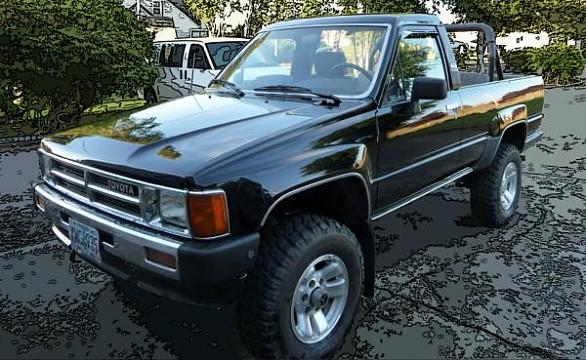

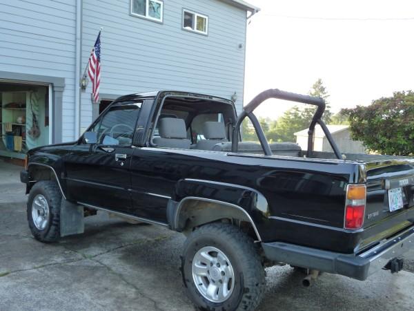

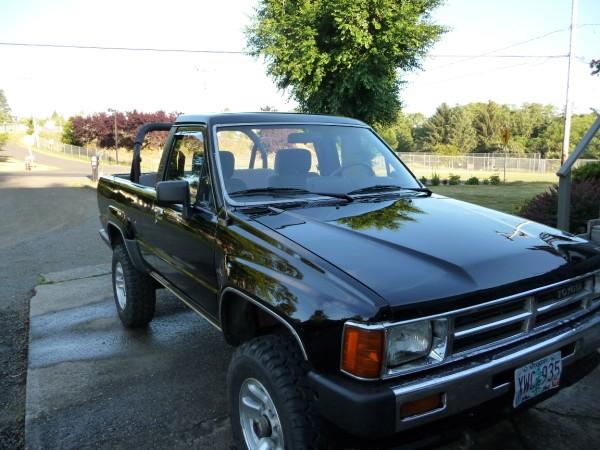

Hello Everyone,
I am trying to make this into the ultimate vehicle to get me to and from the mountain. Being a BMW man, RWD does not cut it, and the XI is far too pretty to be going through snow =)
I would like an opinions on what you think I should do as far as interior (everything is stock) and on a roof rack. Also, any cheap performance upgrades? I have the 22RE, and it is in serious need of some power.
Thanks a lot,
Alex

first off welcome to yotatech!!!! as far as performance there isnt much out there its not a v8 its a little 4cyl they are great motors if you take care of them and by the way nice 4runner. and what all would you like to do for the interior?

Welcome to Yotatech.
Not much you can do on the cheap for power. Obvious things like header, cam, etc can be done and add about 10-20% more power, and most over-the-counter modifications can be done without seriously affecting engine longevity. Not a lot for an engine rated just over 100hp.
Gearing is another option and although it doesn't add engine power, it increases the torque available to the wheels. If you have 31" tires (or their metric equivalent), 4.56 or 4.88 are options and you'd definitely feel a good kick in the pants with 4.88's but mileage can start to suffer since the engine will be turning correspondingly higher rpm's at highway speeds with those ratios.
As for the interior (and gearing and performance mods as well), do some searching with Yotatech's search function or with Google using their "site:" function- for instance typing "4Runner interior site:www.yotatech.com" (without the quotation marks) into the Google search box will bring up search results of all posts including the words 4Runner and interior and limit the results to Yotatech's site.

Mountain rig huh? Sounds like a plan so let me see if I can offer some advice.
Interior.
Pull the carpet all out and line the inside with some sort of bed liner for pickup truck beds. You'll never have to worry about water or nasty carpet ever again.
Swap in some seats from a newer model 4runner. I just swapped in some SR5 buckets out of a 93 and only had to drill one hole. They have all the little adjustments and are a lot more comfortable than the DLX buckets that were in there.
Look for a Tuffy Console (rather pricey) or swap one in from a similar year SR5 Toyota.
Exterior.
As others have said the 22re isn't a power plant by any means. You can get a header for it, a cam, run a snorkle for cooler air, swap out the MAF to a larger one, bigger throttle body etc......
My advice is leave it alone for now but do a complete tune up. Plugs, cap, wires, rotor, adjust the timing, adjust the valves, new air filter, synthetic fluids in the engine, tranny and t-case.
Then decide what size tires you want and gear for those. I run 4.56's for my 31's and enjoy it.
If you decide to do some lift then there are tons of options. I like the ball joint spacers in the front and adding coils to the rear. The coils add a hell of a lot of carrying capaicty and the BJ spacers level everything out.
Oh and don't for get to look at a locker for the rear. I personally like the Aussie.
Roof racks are everywhere just pick one that you like and want to pay for.

As far as not needing a lift I understand. I do wonder though if the back end of your runner is sagging? Mine was and once I loaded up 500lbs of camping crap (when I don't take the wife it's only about 150lbs) the ride was really bad since the factory leaf springs were so tired that I was damn near on the bumpstops. Any little dip in the road and the rear end would bottom out.
The locker might be over kill for you if you never get into anything too serious. I really like mine but then I tend to go way off the beaten path every chance I get. I just wanted you to have an option.
Have fun!
