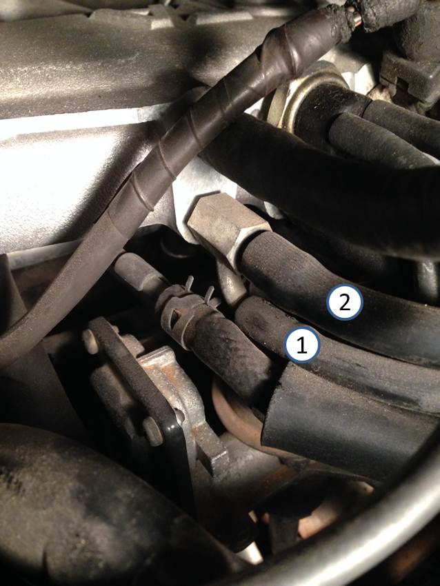

1991 4Runner, 2WD, 3.0L, 3VZE, non-california, 257,000 miles
I located a loose vacuum hose today. Picture attached. (#1) of the hose.
it comes off what looks to be a "y" barb on the hex fitting shown, and the other end is dangling un-connected around the power steering unit. Its a long hose, about 12-14"... I can not see any easy connection that looks like it is missing a hose.
To help everyone locate this hose/fitting/picture, it is the passenger side of the aluminum Manifold. for reference, the Top hose, #2, terminates at the #3 VSV, which is for the EGR according to the FSM link, below.
http://web.archive.org/web/201008061...n/layoutan.pdf
Can anyone point me to the right page/link in the FSM,or a link anywhere else online to help me figure out where this hose should attach to, or the part number it should attach to, so i can search it? anyone with a camera to shoot a picture of their part that this goes to gets good karma!!
Thanks, appreciate the help!!

There should be a vacuum valve screwed into the power steering pump. The hose goes there. Maybe one of the nipples is broken off the valve? Plug the end of that hose if the valve is broken and get another valve from a wrecking yard because they are expensive new!!!
Join Date: Sep 2007
Location: San Francisco East Bay
Posts: 8,254
Received 822 Likes
on
649 Posts
17630-16040 $87 http://www.toyotapartsoverstock.com/...rimLevel=18292
That valve is the power-steering "idle-up," which keeps you from killing the engine when you are parallel parking. As YotaWorx says, the first thing you should do is plug the loose line (if that is the one we think it is) because it is a vacuum "leak" into the plenum. Since it has probably been that way for awhile, someone has probably turned down the idle as an idiot's compensation. Get that set correctly.
Once you get the new/junk valve, when you put it in the idle will stay set correctly.
