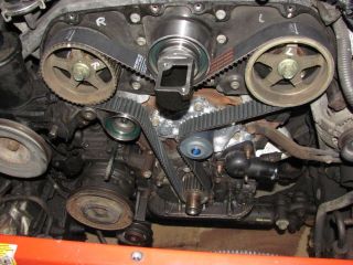

I've already spent $700+ in timing belt/front engine parts so I'm determined to find where this raw fuel smell is coming from.
Attached Thumbnails A Mouse/Mice Decided to Sqat in my Intake Valley-img_0056.jpg

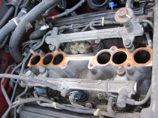

Here's where the mouse/mice were living. I've already removed most the fibreglass insulation. Small attatched pics but it's the best I can do for this moment (better than nothing).
Attached Thumbnails A Mouse/Mice Decided to Sqat in my Intake Valley-img_0057-copy.jpg
