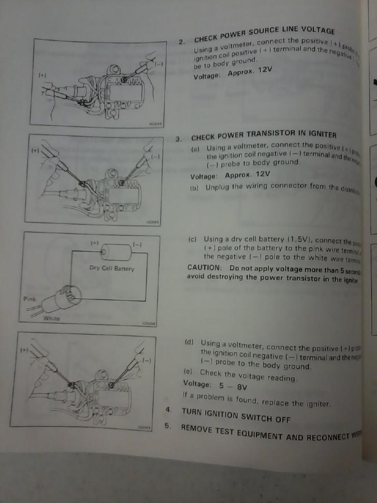

Here is the FSM test for the igniter with the Key On.
Check for air leaks, the AFM connected like others have mentioned.
