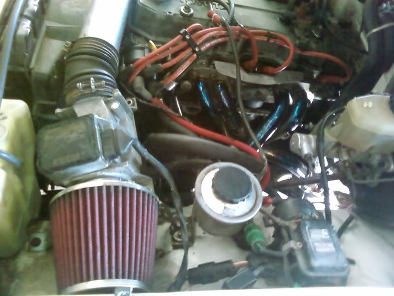

I built Supra AFM by using the 22re circuit board and plug-in into 85 supra housing.Look it up on the search:Supra AFM and find my huge write-up :Supra AFM in 22re.Got pictures and my truck runs smoother on the throttle.
Yeah I read your post. That will work as well. You can do it that way or switch around the wires in the pigtail as well. Also like I stated above if you want to a meter that uses a 5v reference on a 22RE then you need a dropping resistor to go from 8v to 5v.

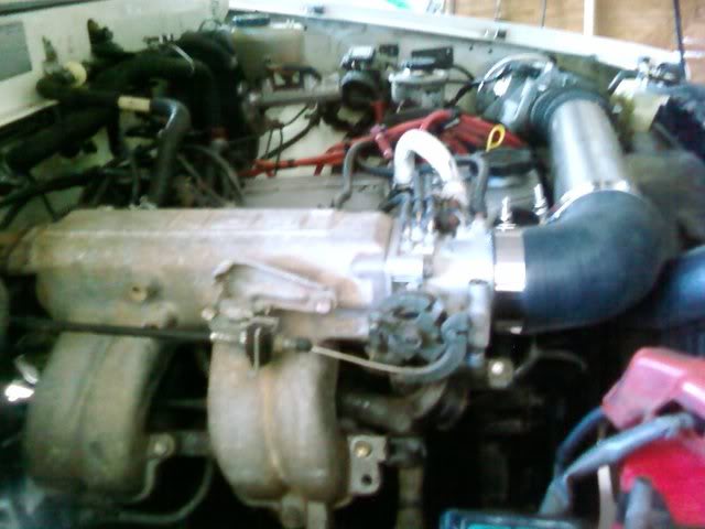

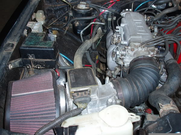

I purchased a silicone tubing that fits the TB & 3" exhaust pipe connected to a 22re tubing that fits the AFM.The AFM is secured by using two bracket that is bolted down on the fender well.Pretty solid.I dont like the air filter but for now it works well.My other truck has the tubing shortened on the battery side.

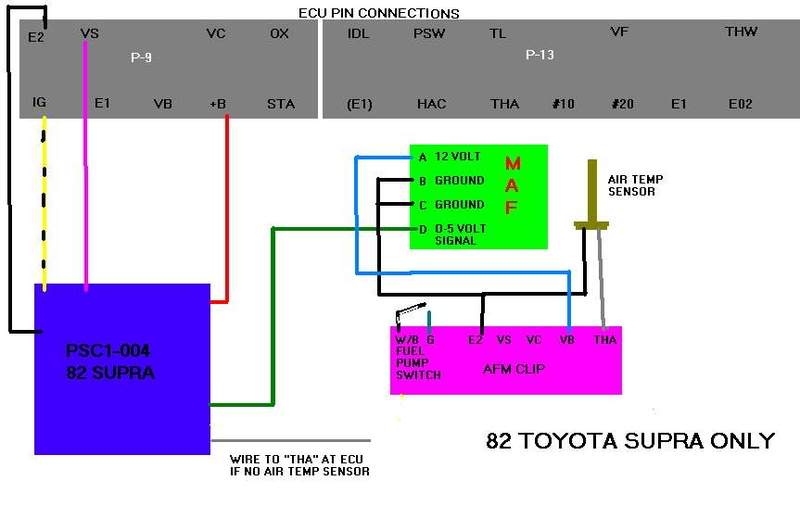

Good thread , i'll give it a try with the one I have here . I will update with pics.
heres some more info for ya
82 Supra afm part number
22250-43110
197100-3020
afm pinout 82 ONLY !!!
